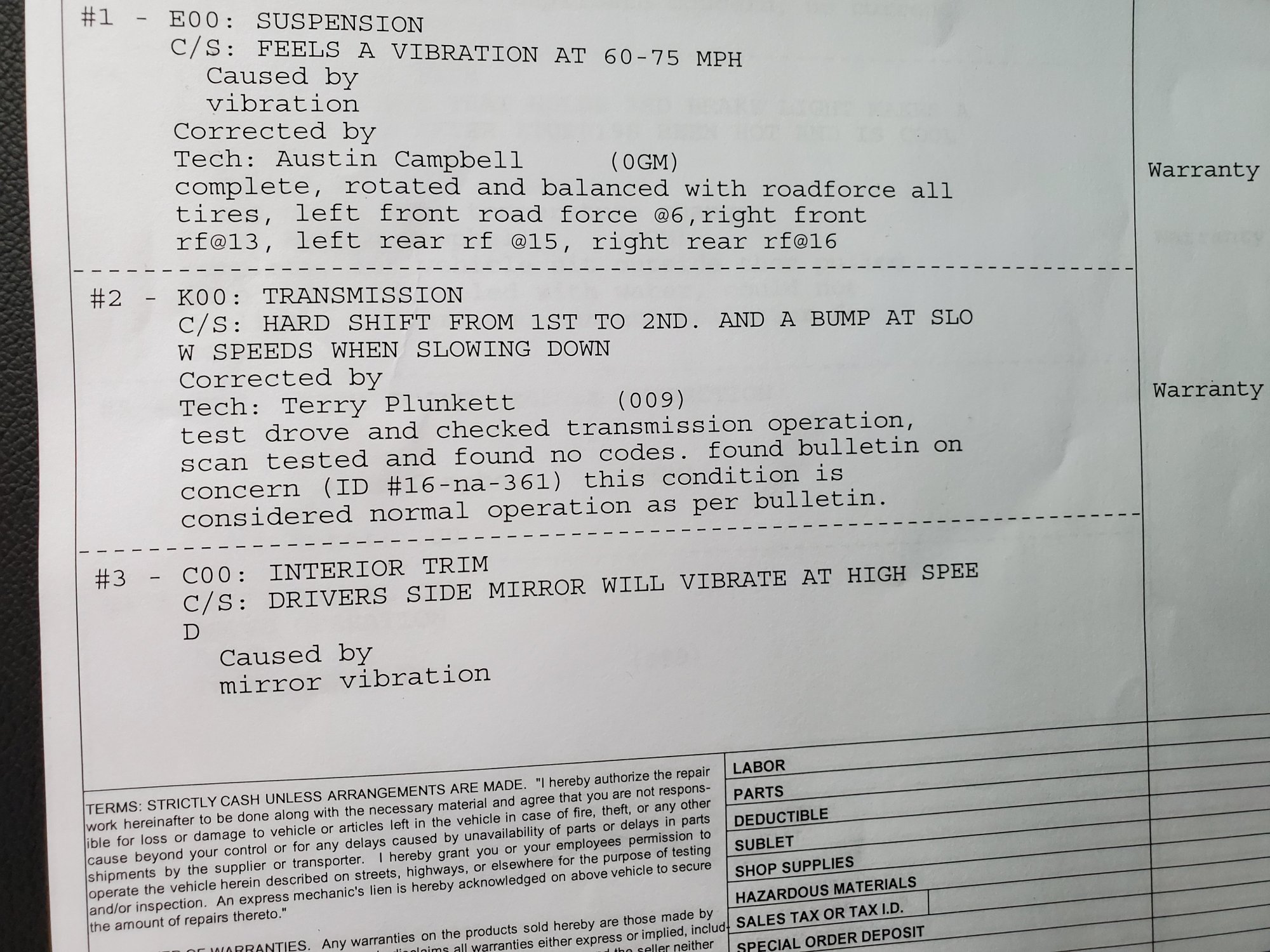

Haven't looked for the bulletin anywhere but this is what I was told this week. Mine isn't that bad or frequent though.

I swear whenever someone else adds to this list the first thing that comes to mind.7c5dd97b6922d3d90f1e9470f41ab19c.jpg
