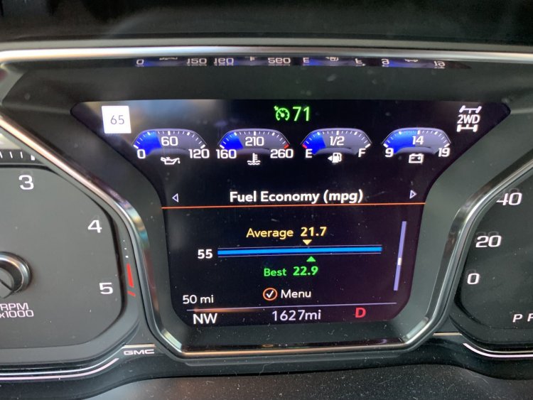

My first fifth wheel trip will likely be around thanksgiving, unless I can sneak away from the wife to the lake before full on winter is here.  Thus far I did a quick 40 mile round trip with the fifth wheel and saw around 10.4mpg.  Unloaded on highway I'm seeing 19.5-20.5 consistently.  Definitely better mileage than my previous L5P and LMLs, and of course much better mileage than my 2017 powerstroke.
Attached picture was a 750 mile unloaded trip about 3 weeks ago, pretty good!
