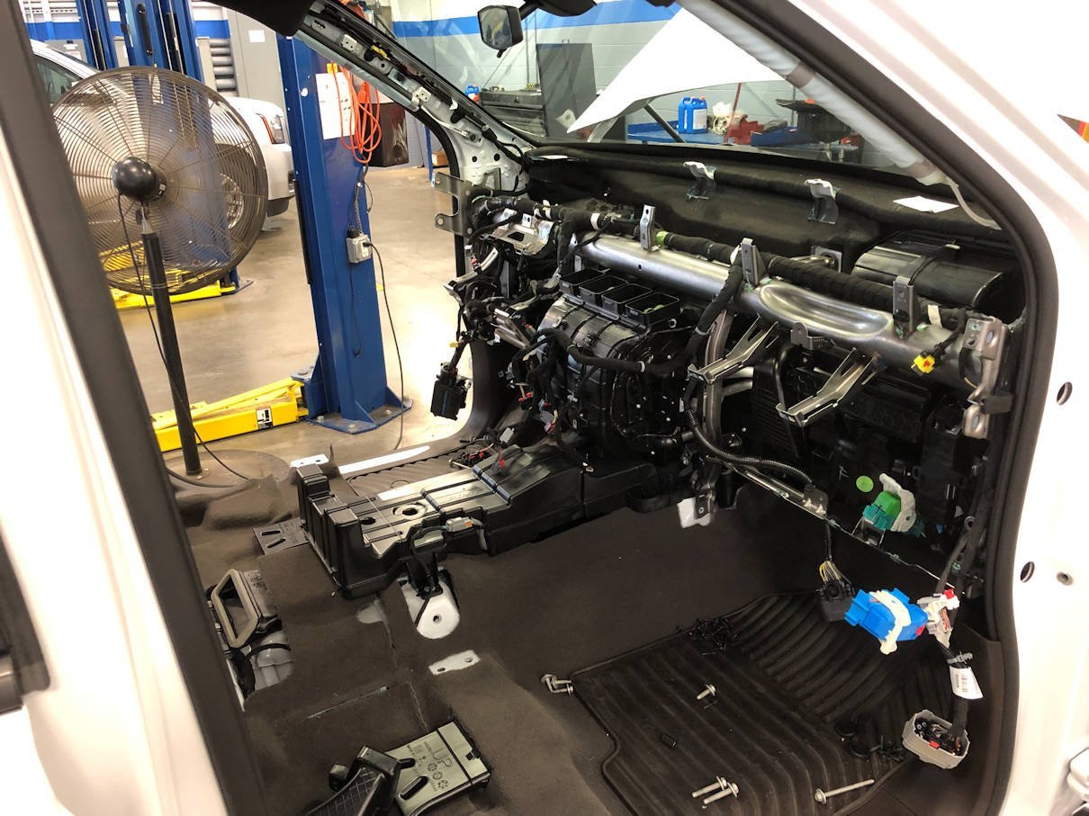

I'm in hot humid Louisiana and must say my a/c works great and haven't had a problem all summer.  100° temps with 115° heat index and blows 38° out the vents.  Hope your a/c isn't on the brink of going out like another members here did.  The whole interior, dash, seats had to come out to change a leaking evaporator.  Not a pretty sight...
Here's (from a member Bill) what an interior of a '19 looks like when changing an evaporator...

Ugggh.
Yep... I never followed up with him to see how the outcome was.
It never goes back the way it was always something after that seen alot of that at the dealerships

I will now be on my 5th attempt at fixing it later today.  Anyone ever get a resolution on the drivers side no AC?  I've had 3 recharges, and 1 damper accuator replacement.  No luck still, and no sign of the dye from the leak.  I have a feeling my truck will soon look like truck pictured above.
