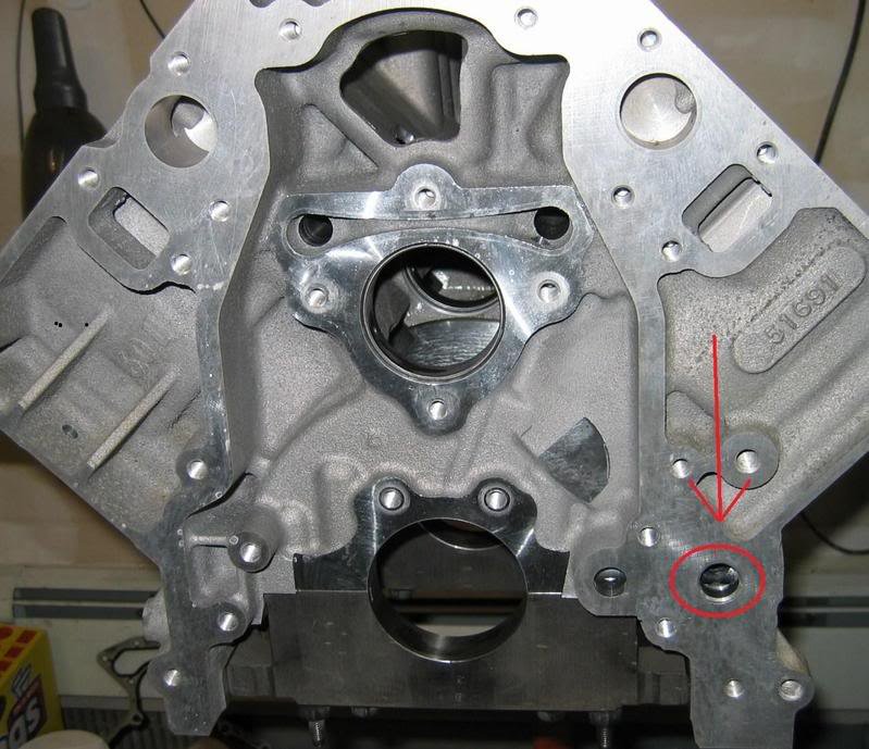

Oil plug is on the front. Bar bell is in the rear.

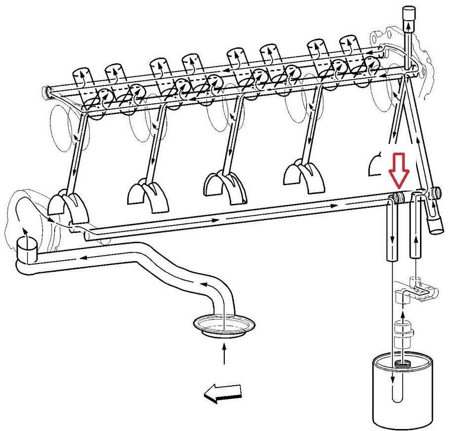

If one of the AFM solenoids is hanging up it would cause erratic oil pressure changes. As you can see in the diagram, oil pressure is release here. I would think it would also run different, but not 100%
