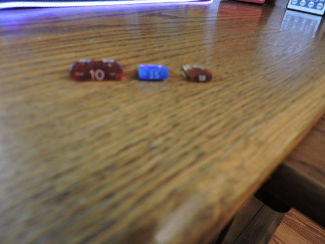

Not any more......there's 4 including the micro2 which is the 7.5 in the photo ...... permits loads more fuses in a smaller box. The heated steering wheel is a micro2....had a hard time finding a fuse tap for that size, let alone a fuse. Reused the 7.5 for the main fuse in the micro2 tap and a 5 for the pigtail feeding the self dimming mirror I added......the heated steering wheel fuse is an excellent place for an ignition controlled tap.
https://www.amazon.com/VIOFO-Circuit-MICRO2-Adapter-Holder/dp/B07K866RPR/ref=asc_df_B07K866RPR/?tag=hyprod-20&linkCode=df0&hvadid=316747946823&hvpos=1o1&hvnetw=g&hvrand=14521907637572293053&hvpone=&hvptwo=&hvqmt=&hvdev=c&hvdvcmdl=&hvlocint=&hvlocphy=&hvtargid=aud-801381245258:pla-586493323860&psc=1
Only place I found my mico2 replacement like my 7.5 was in an expensive set
https://www.amazon.com/Littelfuse-00940570ZXA-Commercial-Assortment-135-Piece/dp/B01N16GVY4/ref=sr_1_5?keywords=micro2+automotive+fuses&qid=1571009975&s=electronics&sr=1-5
