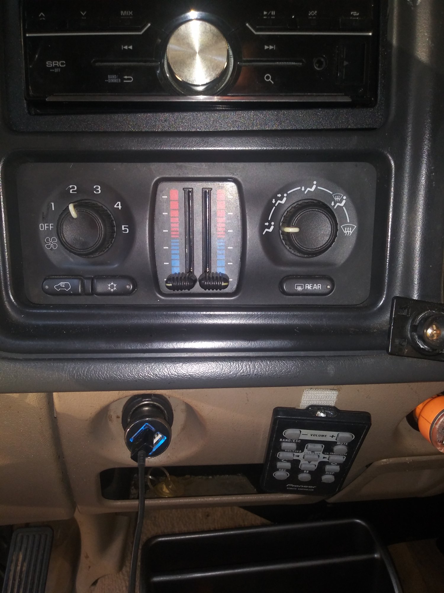

All fuses are good and all lights are working. The 2 issues I have are the cruise just stopped working. Odometer works fine. The other is the air blows cold on hot and hot on cold. The lights didn't work on the climate control box so I swapped out for one identical from a junk yard. Immediately lights worked but the climate was backwards. So I swapped back. It didn't change. So it seems to be permanent now. I've left my battery un plugged for over 24hrs . I've pulled the fuse. And nothing changes
