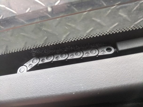

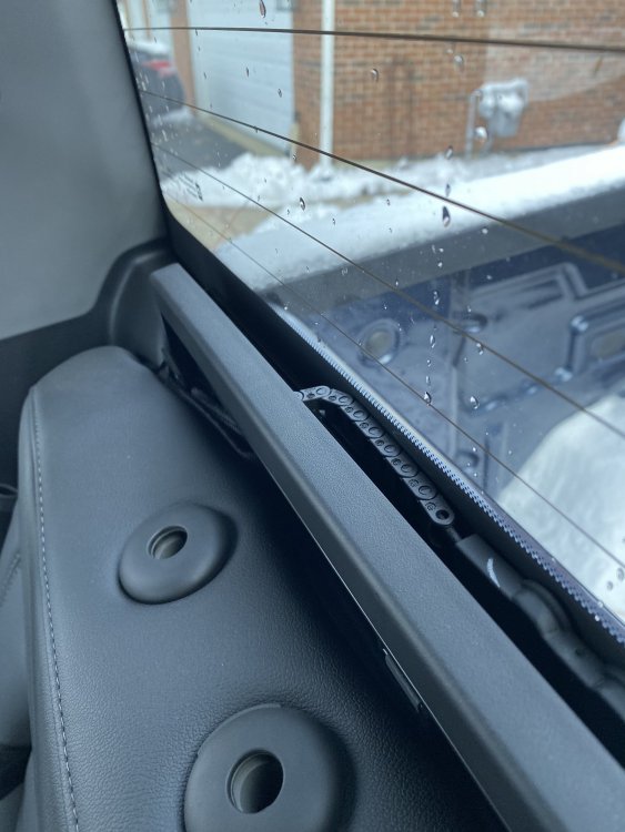

I found out what it is, I’ll attach pictures in a bit, but it’s the plastic linkage that protects the rear slider power wire, looks like a chain but plastic

5.) lastly, check the chain linkage for the rear slider power wire. It presses up against the glass
