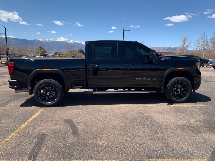

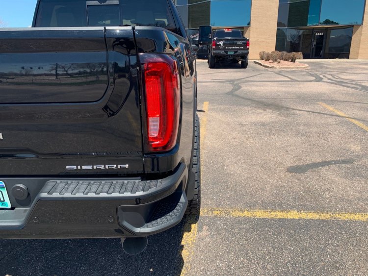

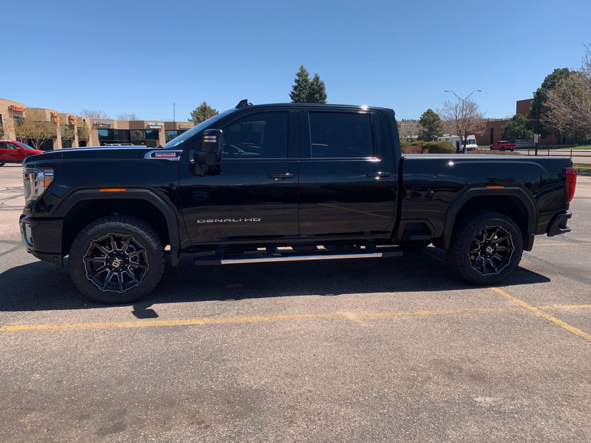

Well here you go! Let me know what you all think this has been a long and frustrating search for wheels but I learned a lot.
Based on my experience I can tell you 2 sizes of 22” tires that will fit with the right wheel. Unfortunately both made by nitto. Not that are a bad tire but the selection is small.
These are terra grappler G2 In 285/55/22
They are damn near exact Same diameter as stock and the speedo is basically exact same as stock. There is no rubbing at all on stock suspension.
You can also fit a 305/50/22 by nitto in the nt420v.
But the KEY is a +12 mm offset I also think a 0 offset will work but the most important spec is as close to 6” backspace as you can get. This is a 10” wide wheel I did find one that was 9.5” and a 6” backspace that would give slightly more clearance but it’s not necessary.
I’m not 100% in love with these wheels but I wanted exposed lugs in black and there are 2 versions of this wheel made by XD off-road
Don’t forget you need load range E tires if you tow with this truck.
Here’s the pics I took today
