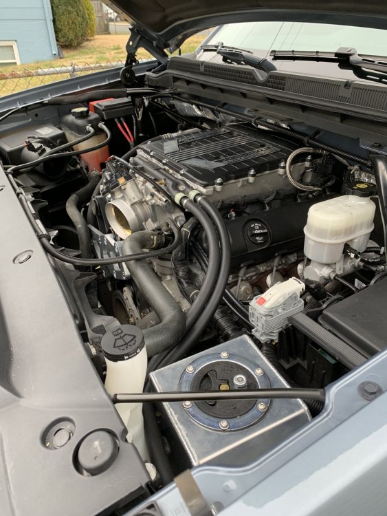

Deleted purge valve, relocated temp sensor in driver side head, deleting vacuum pump, notched all five back lid bolt holes to ease installation because of the little space between firewall, has zr1 throttle body, Crawford racing tb extension, Crawford racing tmap harness, mustang battery size coolant tank, adm performance 6 rib pulley, adm performance heat exchanger mounts and z06 heat exchanger with Bosch pump.
57 minutes ago, Barrywayne said:

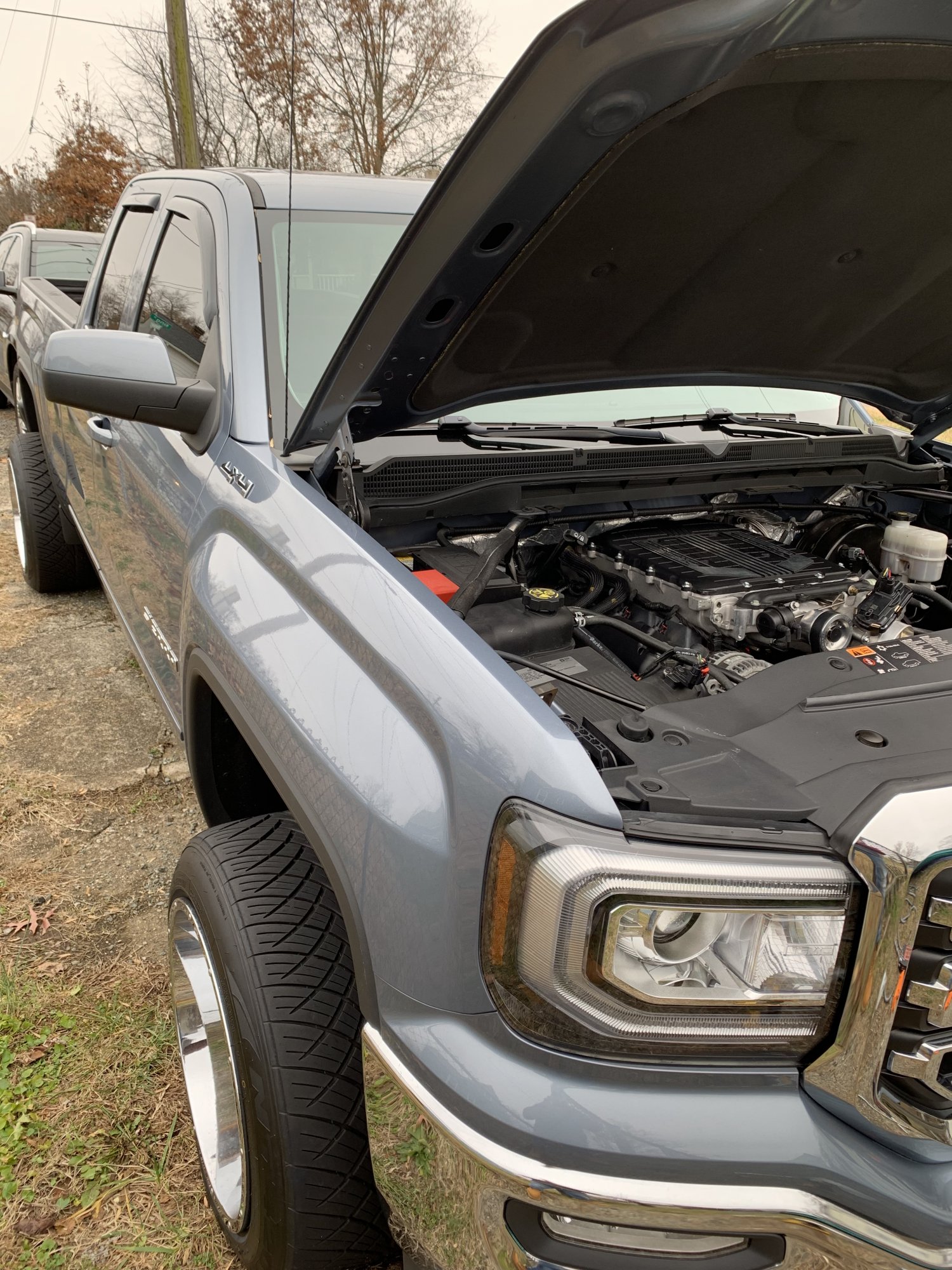

I did a full lt4 supercharger conversion on my 5.3 Sierra this weekend for under 4K
Should have spent some of that $4k on tires that fit.
