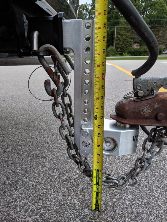

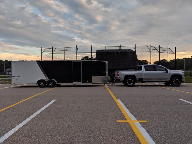

I had to buy a 10" drop hitch to use with my inline snowmobile trailer to level it out. It does have a rather low tongue height as it was an underslung frame design to make it wider than their normal inline trailers. In the pictures I have 800 lbs of tongue weight. I had written down how much sag I had with my 2013 1500 Silverado with air bags and how much the 2020 2500HD sagged, but I can't find that paper right now. I did just pickup 22 cement blocks at 33 lbs each, so that was supposed to be 726 lbs and the truck sagged 1 inch measured at the top of the rear fender.

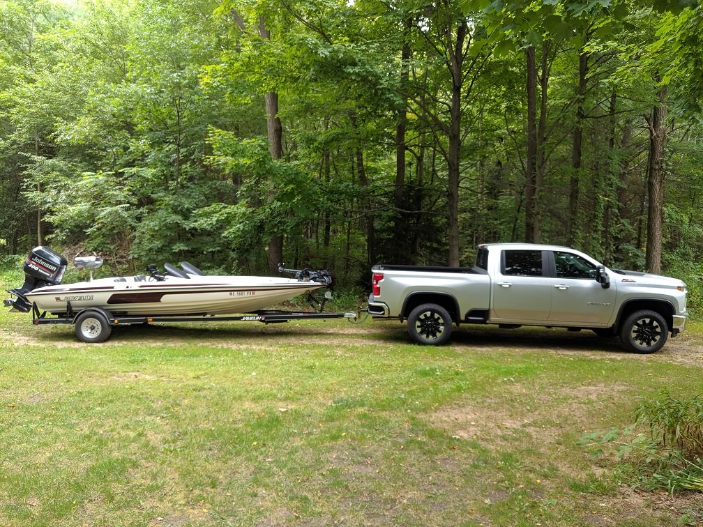

The picture with my bass boat was with a 6" drop hitch that I had when test driving the truck and was the lowest hitch I had. I bought a used fixed 8" drop hitch to use with the boat. I haven't checked to see if the boat trailer frame is level with that hitch but it should be close.
Right now I'm changing up my custom set of hitch mounted mud flaps as that 2.5" Weigh Safe hitch doesn't have enough room to mount a set of Rock Tampers or my custom set. The 2" Weigh Safe hitch does have enough room though, but is rated lower for capacity. Just something to think about as I figure most people that pay a good chuck of change for a big drop hitch are going to be pulling a nice trailer that they want to keep protected with some additional hitch mounted mud flaps.

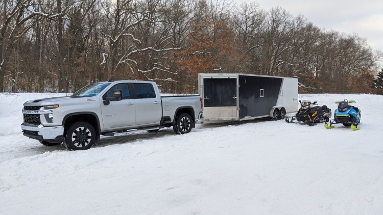

What length inline snowmobile trailer is that, 28'?
It is 29 ft long X 7.5' wide and 6.5' tall. I was able to fit 5 full size sleds and 1 Mini-Z sled in it a few weeks ago.
