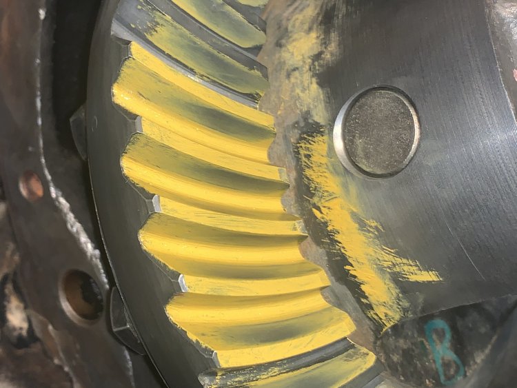

Help! Rebuilding rear end. Check my pattern.

Looks decent to me. Just make sure your rotational torque at the pinion is within spec with ring gear/diff removed. Make sure backlash measures in spec. Use a dial indicator, you should be good.
