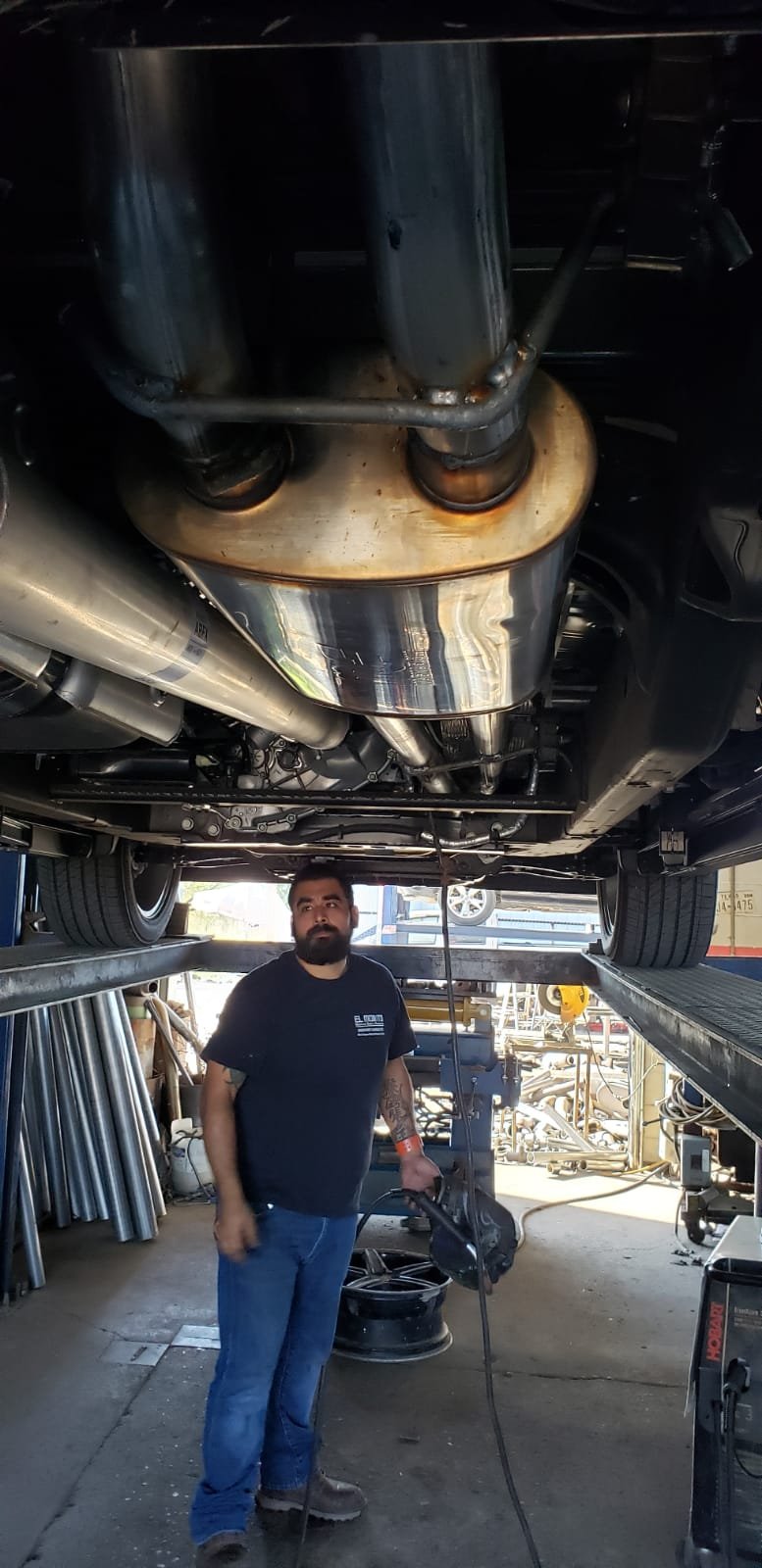

I did a full tru dual on mine split the Ypipe into 2 and went into a 22" magnaflow dual 2 1/2" in and dual 2 1/2" out on mine, I have a 6.2. I was surprised at how quiet it is. I was just looking for a lil better performance and didn't want much noise if any at all. I have ZERO drone at any speed and I really can't even hear when DFM kicks in. The stock exhaust is very restrictive, the flapper before and after the stock muffler cover about 40% of the pipe when fully open not to mention how long it takes before it fully opens when you mash on the accelerator.
