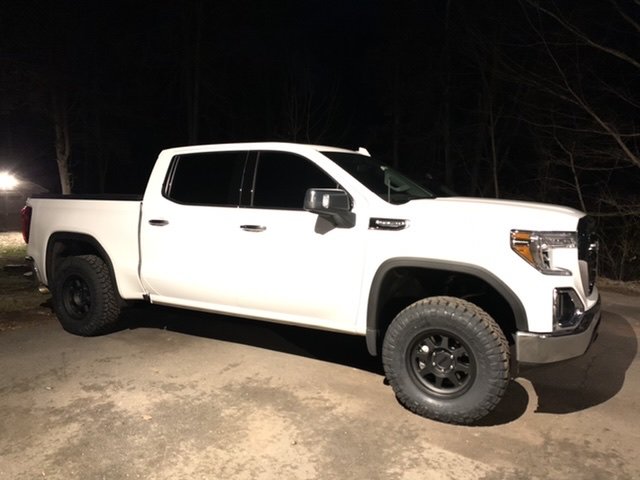

Went with the CST coil overs on mine.  With a 1.5in block in the rear. (Should have went 2 inches in the rear) I Eventually need to get the upper control arm but they come stock with a 2in level and you can adjust them up to 3 inches. I don’t dip in the corners anymore they are smooth on all bumps and dirt roads.  Install wasn’t difficult and I had the dealer do an alignment after I put them in. (Had to bring it in for the seatbelt recall anyway) 1B246E7E-4122-4C5F-84E4-E6D0D95E7E9A.jpeg.8cdcb5b1e8512d823b5c436146f4cf85.jpeg792EC61A-E014-4DEE-BFBC-C7D784DE19DF.jpeg.f7bcb49158d2b43380c0f0416472b8aa.jpeg
Great input guys! Justin what size tire are you running? You also look to still have some rake? Your truck look great by the way!
I will call a couple companies today and see if getting them set to 1-2” from the factory is an option. I assume doing any of this will void my warranty on the from and rear suspension parts?
I’m running 295/70/17 ridge grapplers And MR701 Method. They didn’t rub at all. Very close but didn’t have to trim anything.

So I went with a 0 offset on the methods, 5EA31048-598D-4E50-ACDE-FCC96740053F.thumb.jpeg.29de9a3cec8b22c3f24c34f7686ccec2.jpegno spacer needed for the “new caliper”with the MR701. The side wall of the tire just pokes out, it ended up being perfect. I didn’t want to have rock and shit kick up and ruin my paint. But I wanted that aggressive stance.
I started a thread about mud flaps cause it does throw a little and the stock flaps don’t do shit. I’m sure with good mud guards I won’t have any throw back on the truck.

That is the exact stance I’m looking for!! You have helped me end my search for pictures!!

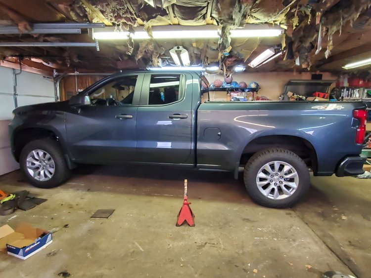

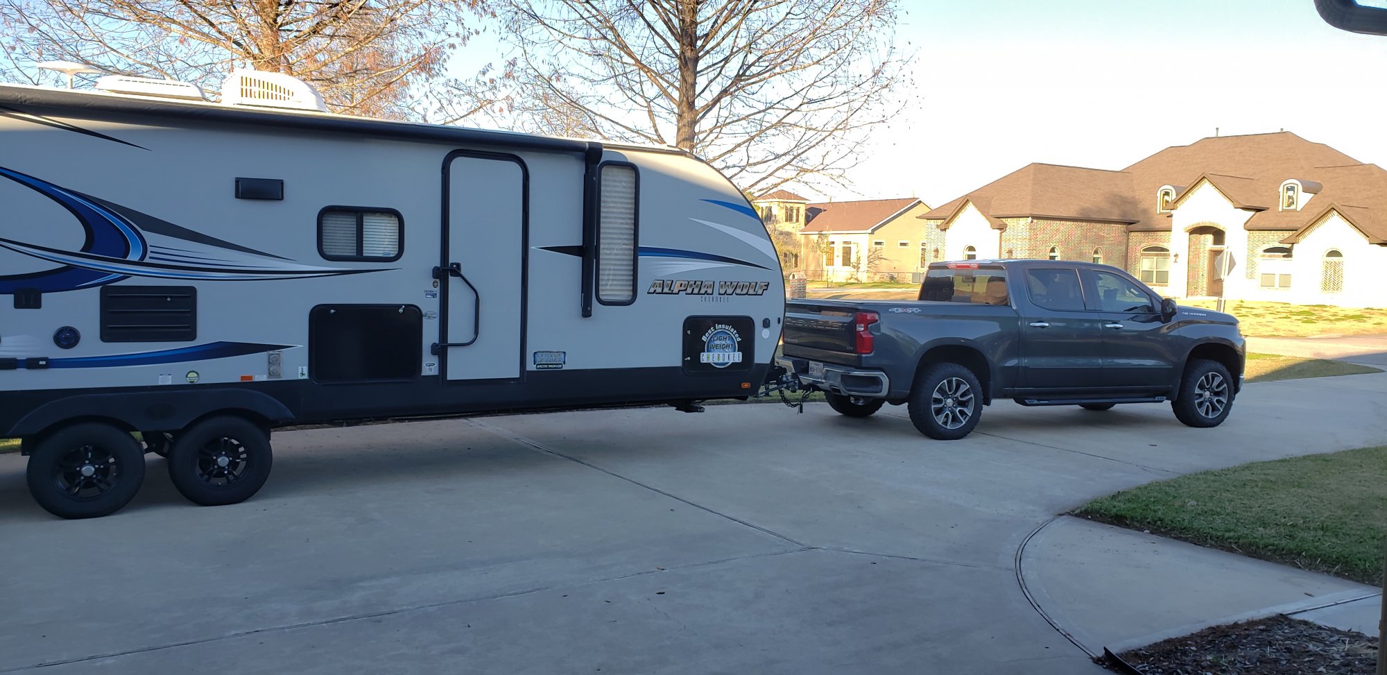

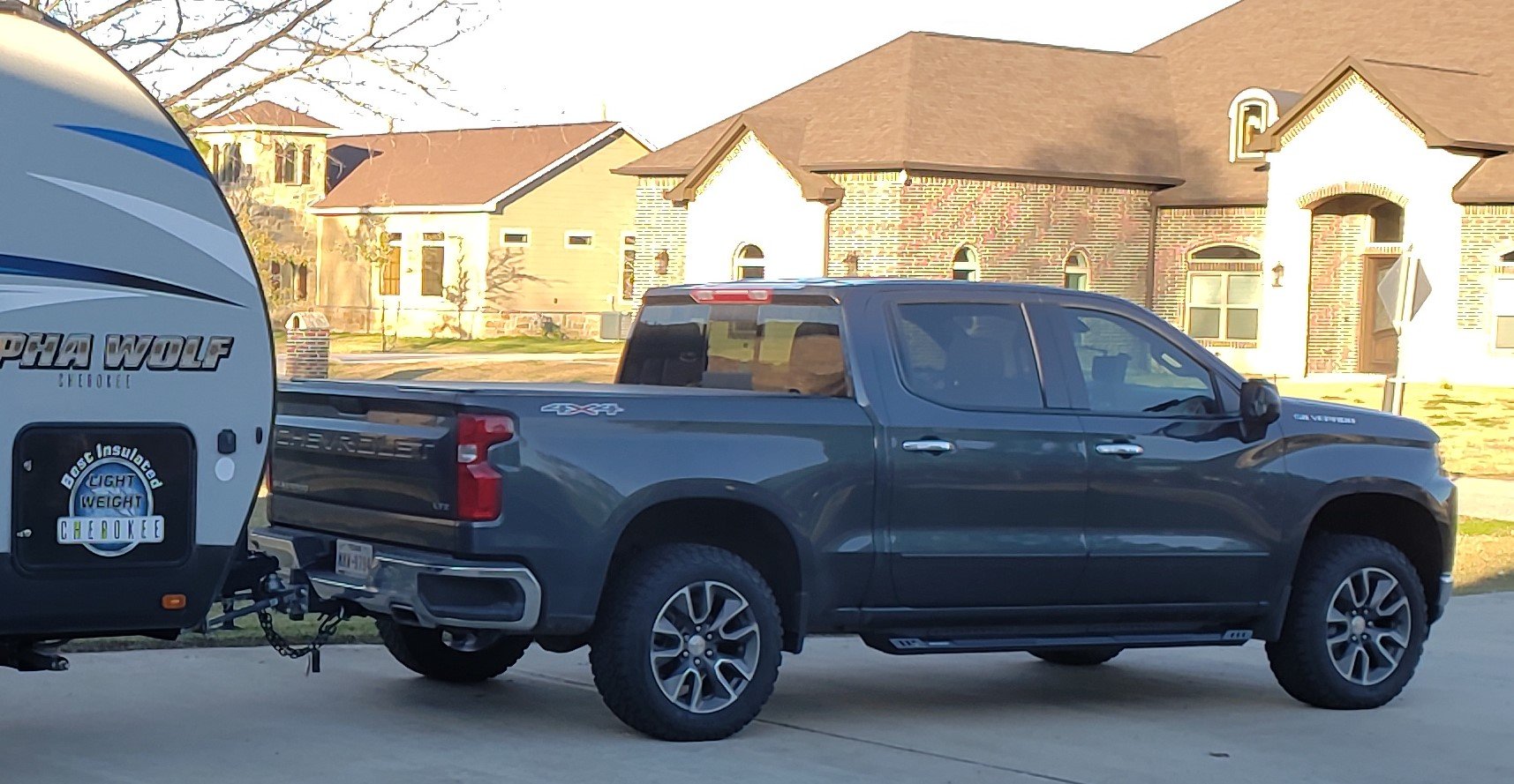

I had 4600s on the back of my old truck and they rode super smooth.  5100s up front.  The 5100s should come out this year according to the Billstein rep I talked to last fall.  I did 2" upper block in the front and a 1.5 in the rear.  Left me with .75" rake, unloaded.  I would probably do 2 and 2 if I did it again.  I added AirLift bags to the back to keep it from squatting under load.  It rides like a dream when I tow the camper.
I may change out the rear shocks though.  Not sure what to use.  4600s are not really for lifts.  Currently on the stock shocks I have 2" spacers on them and they ride okay.  I had ridge grapplers in 305/55/r20 on the truck and it rode super smooth.  But MPG went to hell.  I traded them out on 275/60/r20 (stock size 33s) BFG KO2s.  It tows great.  They are a hair louder and a little rougher though.  Better MPG, likely because they are narrower with less rolling resistance.
