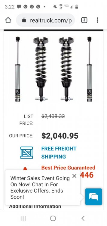

Will these work on a trail boss??
I want to upgrade to fox shocks or king or something. I dont really know anything about coilovers. Any info or recommendations are appreciated. Thanks.
These should work on a trail boss, I dont see why they wouldn't.  Set at 2 inch will be what u have now. Set at 3.5 will give you 1.5 more than now.
Way cheaper at poly performance tho, I bought the stage one for 1375 black friday, cheapest I could find them.
king has set for TB (different than std height when i was quoted)....about $2400 for fr/rr, and believe even fox has some too
icons are stiffer from what ive heard
digressive valving vs progressive valving
one starts out stiff and gets softer, other starts out soft and gets stiffer
have ridden in king an fox setup but have no comparison to icon
sure theyre all good, icons supposedly shine in harsher conditions, more you push better they are
