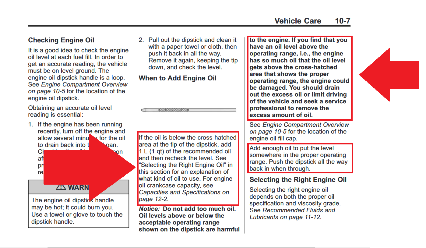

GM recommendation is midpoint on the hatchmark.
Wouldnt that mean its low 1/2qt?  I have never read that anywhere. Just curious where did you get that info?
Oil level below crosshatches is LOW
Oil level above crosshatches is HIGH
Oil level in crosshatch area is normal operating level
Directly from the owners manual (pretty useful little book...GM should think about putting them in every vehicle)?
Screenshot_2020-01-17 Owner's Manual - 2013_chevrolet_silverado_owners pdf.png
Yeah asking how to read a dipstick wasn't the question. Maybe there should be a reading comprehension manual for people like you before you post ?
And this wasn't a "how to read a dipstick" post. If you would have read the manual before posting you would have seen that it clearly states if oil level is below the crosshatched area, then you add oil.  If oil level is above crosshatched area, you should drain the excess oil.  That indicates that the crosshatched area is the "proper operating range".  It then goes on to read "Add enough oil to put the level SOMEWHERE in the proper operating range" ie, the crosshatched area.
Maybe this will be the answer you're looking for...
With my '10 Sierra, sometimes the oil level would be at the top of the crosshatched area.  Sometimes it would be in the middle of the crosshatched area.  Sometimes it would be about 1/4 up from the bottom of the crosshatched area.  But, it was always in the crosshatched area (just like the f'n manual shows).  Now, is that what you were looking for, or do you want to nitpick someone's reply a little more??
