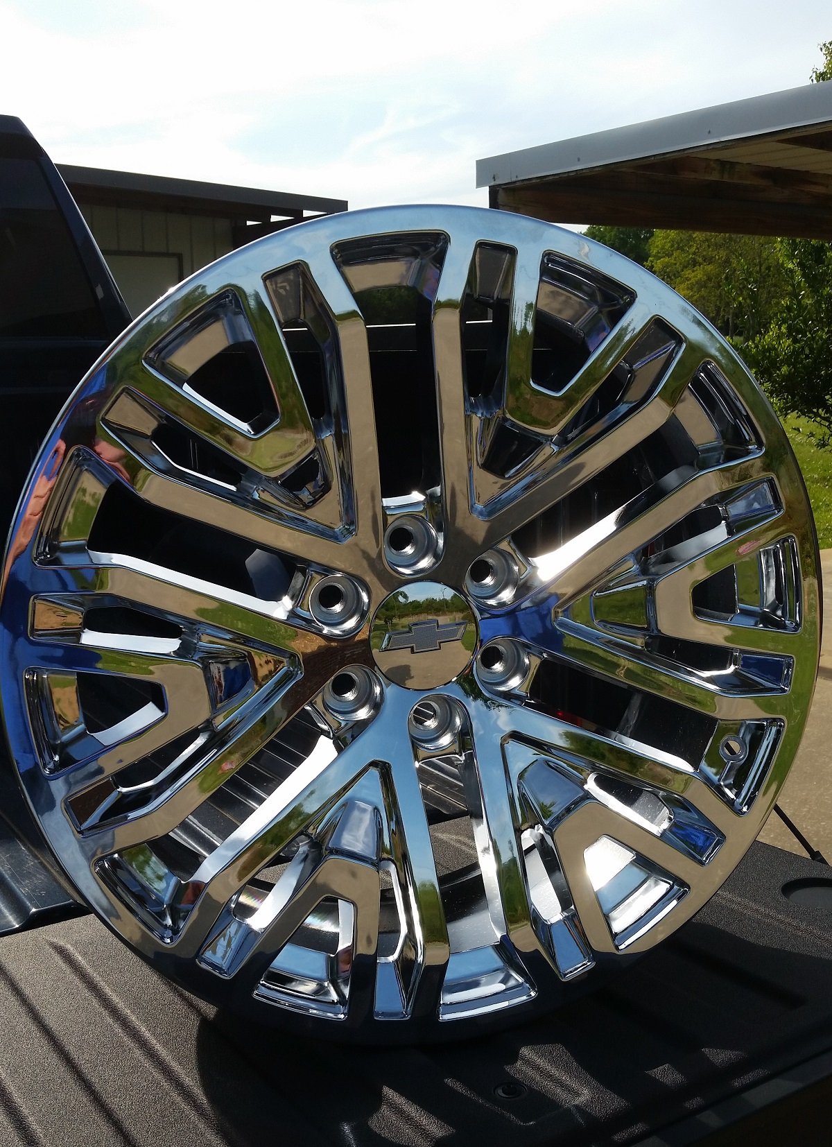

1st off is, I wouldn't use spacers especially 10mm.  Using a 10mm spacer makes the wheel lug centric instead of hub centric.  Lug centric is using the lugs to center the wheel instead of the hub.  GM trucks don't like being lug centric and are prone to vibration.   A 3mm spacer is the thickest you can run to remain hub centric.  A 3mm will clear the caliper on some '14-'18 wheels but not all. The hub is around 8mm thick so with the taper on the wheel and on the hub, 3mm would be max on a spacer.  There are no 3mm 78.1 6X139.7 spacers readily available that I know of.  One company custom makes them for $105 a pair.   Hub centric bore is 78.1 and the bolt pattern is 6X139.7.  I'd get the correct wheel that clears the caliper without spacers.  Check the OE Creations wheels from WheelPros.com.  Search year make and model then wheel type (OE Creations under brand).  They have the new style 2019 GM wheels.  I purchased a set of the PR196 (2019 GM style).  I can attest these wheels are top quality with a beautiful flawless finish.  Fit is perfect and they required little weight and balanced out perfect.  You'll be satisfied with these wheels and they are as nice of any wheels in quality you will find.  A friend purchased a set of the PR197 which is also a nice looking wheel.  Here's my PR196's in 22" using OEM center caps and my friends PR197 wheel. I've gotten many compliments on them.  Keep us posted.

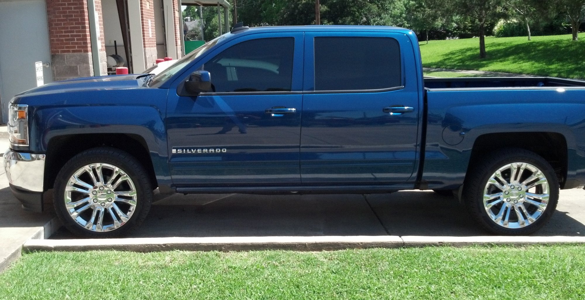

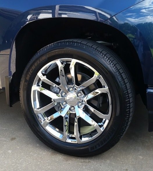

Factory Reproductions are good wheels.  I've had 2 sets (pics below) with no problems.  When I was looking at wheels for the '19 FR didn't have any wheels available for the '19.  I found OE Creations and couldn't be happier.  Whichever wheel you decide on, be sure it's a '19 specific wheel without spacers. This will save you issues and headaches.
