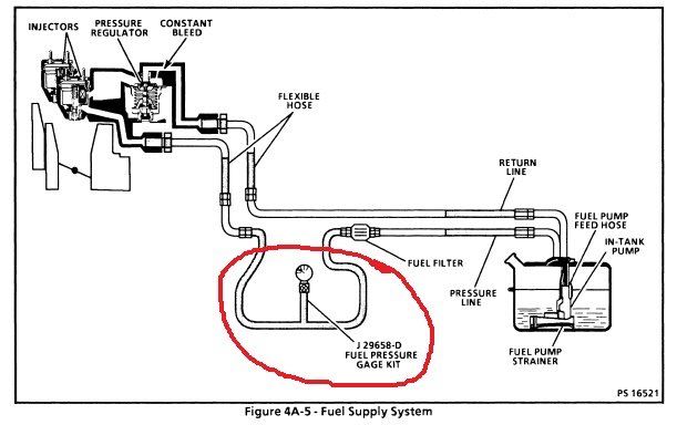

I have read this section in the shop manual, seems like it need an adapter to insect before and after the fuel filter, and if change fuel pump, gonna need much job because this need to take the fuel tank.
Maybe I can change fuel filter first? Though I think faulty fuel filter can cause power reduce but can't cause stall. My Ford F-250 used to have fuel filter problem when I got it.

For fuel pressure, I don't have the tool to measure the fuel pressure, so I tried another way.
Loose the nut for the fuel injector's input pipe, use jump wire on fuel pump relay socket to manually activate fuel pump, I can see fuel come out.
According my shop manual, the 454 engine should have 26-32psi, that's about a car's tire pressure, but I see the fuel come out very soft, not like 26-32psi.
So looks like I need to change fuel pump?
