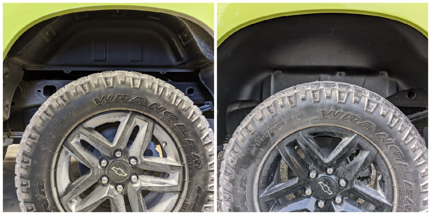

Not the best angle, but those are 1.5" spacers from amazon. About $100 shipped.
I've been running them for 3 months, with a large trip to Florida from Michigan, hauling a bike trailer.
No issues. Locktite.
