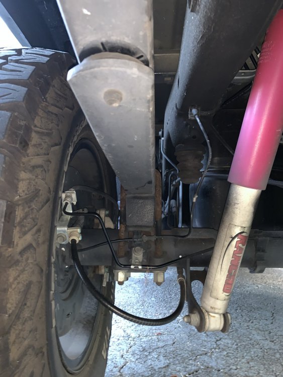

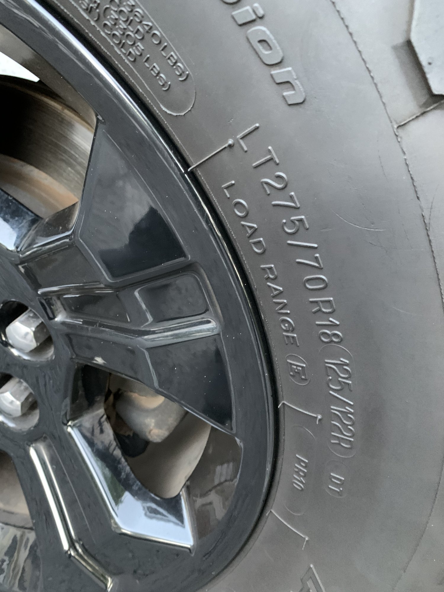

I recently bought a 2017 Silverado Midnight edition and I'm trying to determine if it already has a leveling kit or not installed. It looks fairly level to me but I just wanted a second opinion to make sure. I'm trying to find out more specs if possible (size, brand, etc). It currently has 275/70/18 tires if that helps. Thanks for help!

It doesn't appear to have a level from the pics you posted.  Measure from the fender lip to the ground at the center of each wheel.  If the front is within 1" of the rear, it likely has a level.  Most stock trucks are 2-3" lower at the fender at in the front compared to the rear.
I would say no, but a pic of one of the front struts top to bottom from the front of the truck would help.
