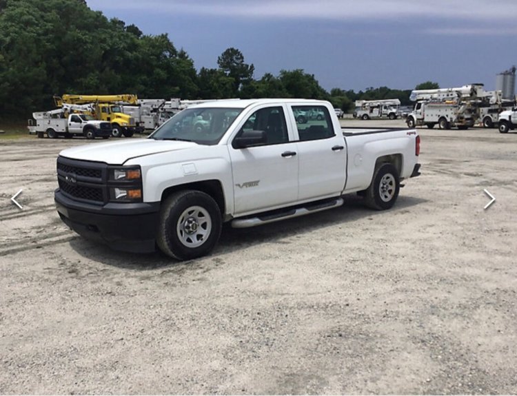

Hello: I have a 2014 I bought it a month ago from a auction and have it delivered to my mechanic for a service before I can get my hand on it, fast forward to yesterday I picked it up and I was driving it home when the warning ⚠️ light came on and just let me stranded in the middle of the highway apparently the gas engine it’s not charging the batteries… any advice?

I saw that auction. You got a great price on that thing. Reach out to Via Motors. Their tech line is really helpful. You'll likely have to rent diagnostic equipment from them to understand what failed, then go from there. Sorry I can't be more help. Please let me know what you find!

Update: I spoke with Travis, (nice dude) he said the for what I told him it could be the APP Module🤷🏻‍♂️@ $70 so and pretty easy to replace or option (2) rent diagnostic equipment to see what else can it be.
i’m going to roll the dice and go for the module first..

That's great news! For $70, I'd roll the dice as well. Good luck!
