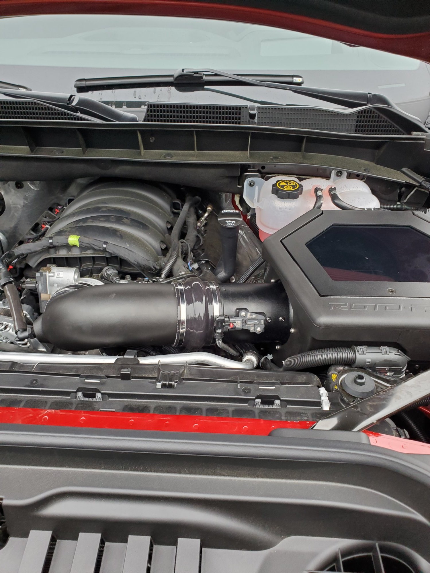

Anyone running the RotoFab CAI on a 2021 with a 6.2L? Any fitment issues? Codes? They claim it makes the truck "sound" different?? Just looking for real feedback.
Installed mine a month ago. 2021 gmc 1500 AT4. Fit is perfect and clean. No codes as of today. Clamps and parts are solid. It does give better sound.  I have the gmc performance exhaust and it made it gave it a better tone.  Definetly can tell its pulling more air. I researched a lot of CAIs and glad I went with rotofab.  Just remeber to disconnect negative battery terminal during the install....its all in the step by step instructions.
