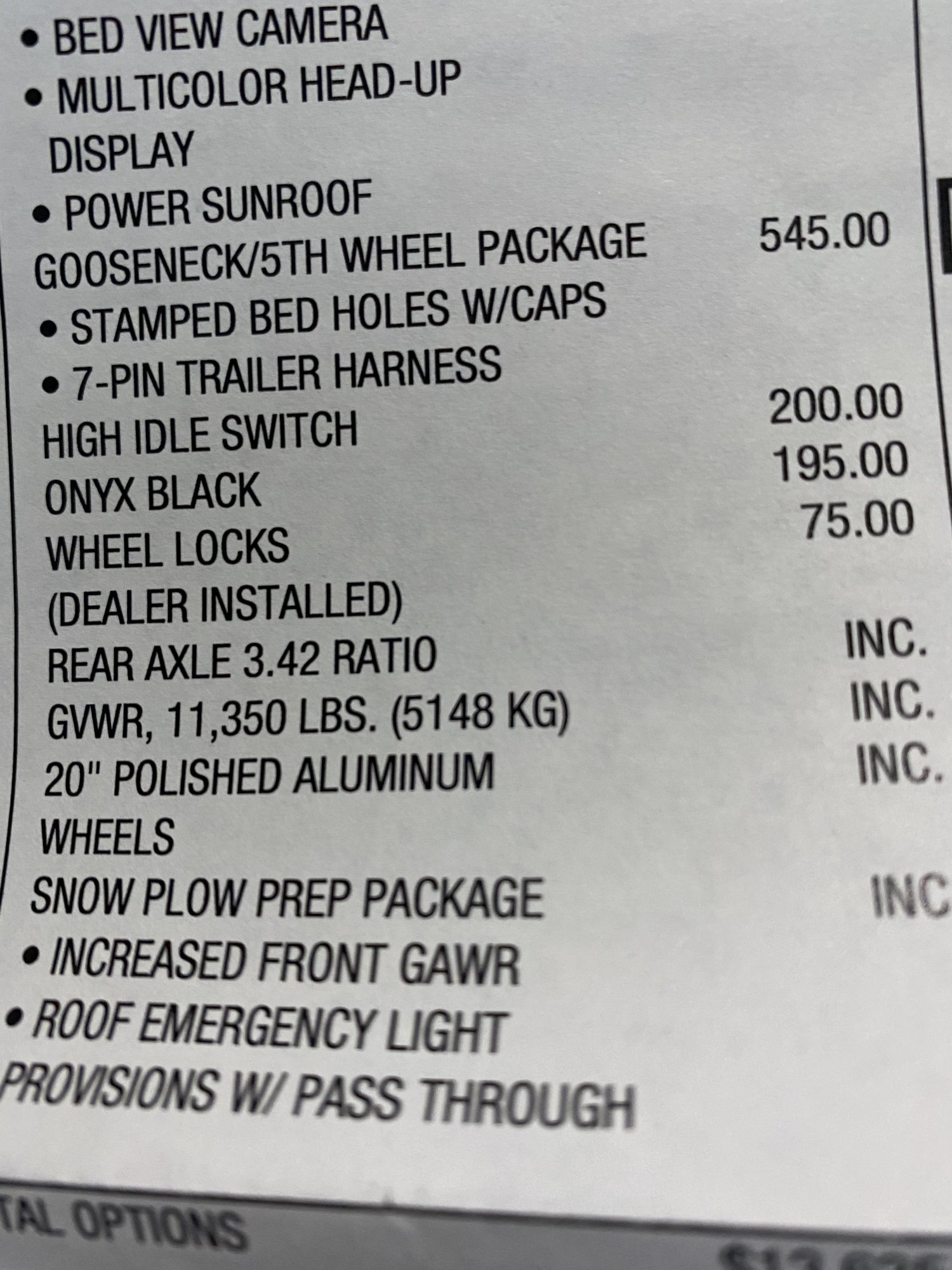

Set the parking brake, hold the cruise button down a few seconds and release. Works ok for me. Check your window sticker/ build sheet. Its  $200 option. The dealer should be able to set it up if you dont have it since its software only.

Yeah I don't see it on the window sticker. I'll look into having the dealer set it up
No rush, but if you get a chance can you take a picture of what its listed as on your window sticker? My dealer hasn't been much help. They keep trying to tell me that I don't have PTO and I keep trying to explain to them that's not what i'm referring to.
They don't seem to understand that Elevated Idle, Fast Idle, and Power Take-off are all different features.
