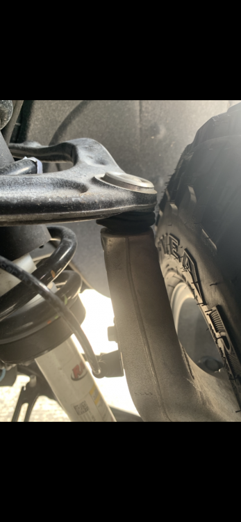

305/70/18 should work, right? Only 12” wide
I Called ready lift again today, they said any tire over 11.5” wide with stock rims isnt recommended as it may rub. They have 6mm spacer kit and they actually said it will help stock rims with wider than 11.5” tires clear the control arm.
