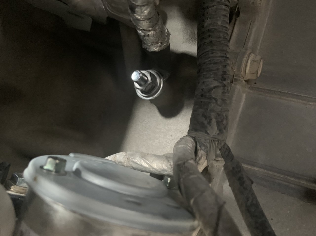

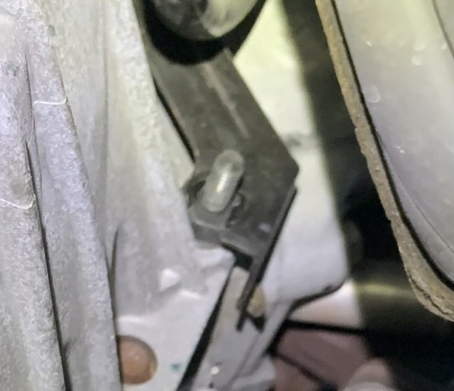

So I was able to salvage my existing cable. I flattened the contact area and bent the lug back to the original 90° configuration. It reached to the spot on the block next to the starter (2015-18 location)with no issue other than unsnapping one of the clips. Coincidentally the clip lined up perfectly with a correct sized hole in the chassis. I did a voltage drop test from the battery to the braided jumper on the driver’s side bulkhead and the positive battery cable. Both were well under 1 volt. I just put a nut, lock and flatwasher in the old  location to hold the dip stick tube on.
