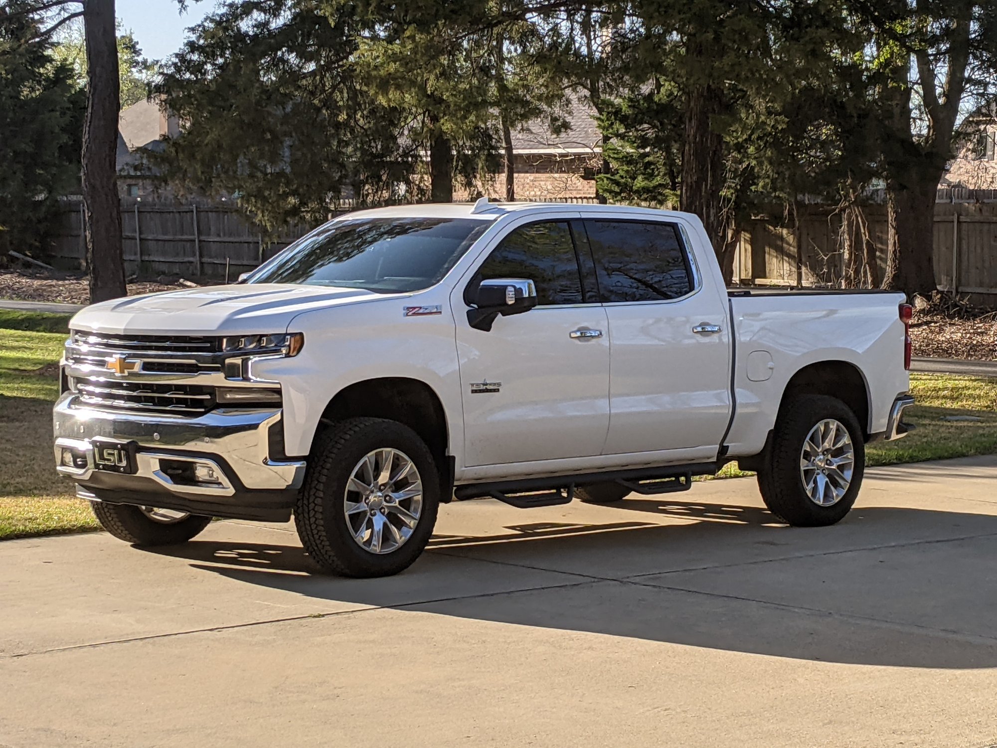

So I completely forgot to do ride height measurements with my 1.5 spacer compared to the 1.2 the 6112s provide. I can tell there is a slight rake which I prefer anyways since I load up my bed with crap a couple of times a month.
I can say it's a very noticeable difference from factory as far as ride quality. The truck is far more composed and planted on rough pavement. Body lean is vastly reduced and the truck has a firm confidence inspiring feeling. I'll probably hit the trails tomorrow or next weekend and share the differences there vs the stock suspension.
I know a lot of people mentioned this being night and day compared to the stock ranchos, while not to that extent IMO this was definitely worth the price paid.
