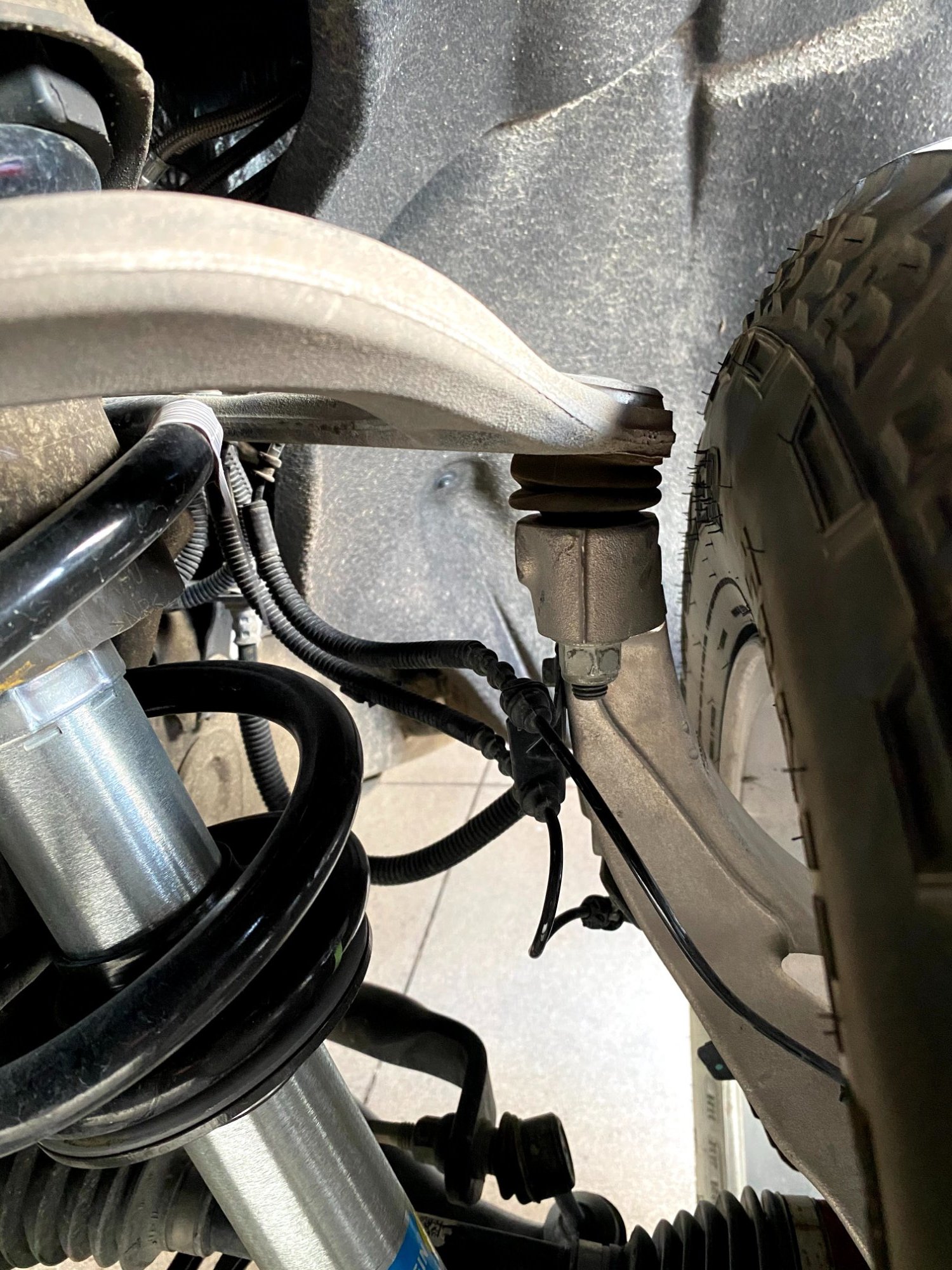

Looks great! Do you recall what setting you had it installed at? Any sag after 2+ months? Looks real close to level.
Thank you. Set at full 2.0” lift for the 3.0 diesel. I also added a rear block to maintain about 1.0-1.5” rake. It surprisingly looks level but there’s still a rake and I have some wood and deer corn in the back. I have not noticed any sag yet

8 hours ago, BowtieBill said:
I may consider it. But the 5100 only gives 1.5" lift at max setting for the 6.2L Crew Cab. I was looking for 2". I have already purchase 1" rear blocks.
What do you think of the ride with them at the highest setting?
Absolutely love it. It is a nice firm ride that handles the road elements exactly how I wanted (speed bumps, pot holes, rough roads, railroad crossings, highway undulations, etc).

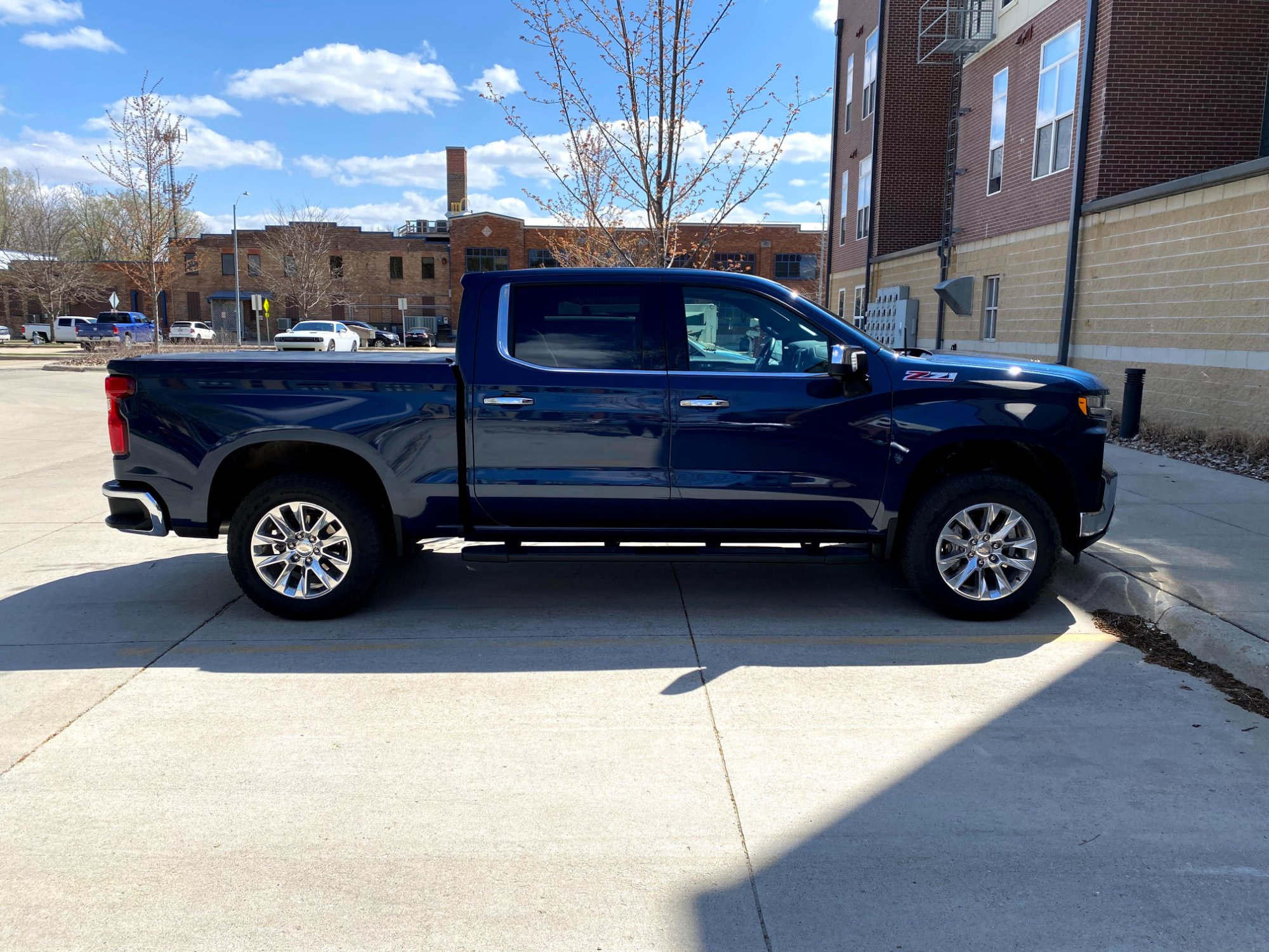

Got the 6112's installed front, 1" block & 5160's in rear. It measures 39.5 at all four corners. I think it looks good. So far I like the way it rides, firm but not jarring.
Now, the hard part. Which wheels & tires..........
Heavier/bigger tires/rims should soften it up a bit.......tough compromise...cant soak up nasty hits offroad and ride smooth on street....no shock can do both well so always bit of give and take depending on where you want most emphasis on

Personally, I am not looking to soften it up. I stated that I like the way it rides.
