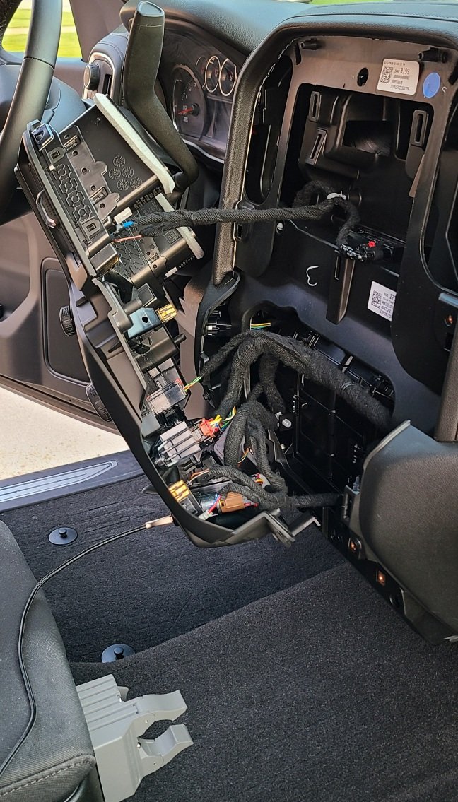

I got mine from "autostopeliminator.com" here:
https://www.autostopeliminator.com/collections/most-popular/products/2019-silverado-sierra-autostop-eliminator
SUPER easy to install for one person to do.  I have a 20 Silverado 1500 without the full center console.  Its literally removing three pieces of trim, 6 screws, popping off the center stack, and installing the bypass wire harness.
Took me 30 min, would have been less if I could have gotten the single 7mm bolt out quicker.  Its LONG .....I finally backed it out with my drill faster lol.
Works perfect.  I shut it off and it remembers my setting with each engine start.  I can turn it back on any time I want, and again, it remembers your setting.
