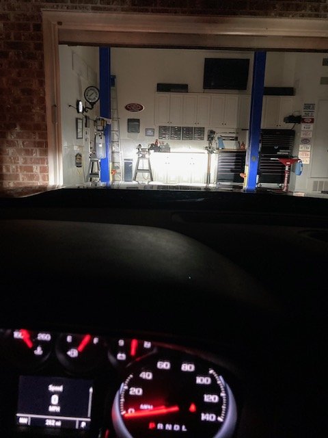

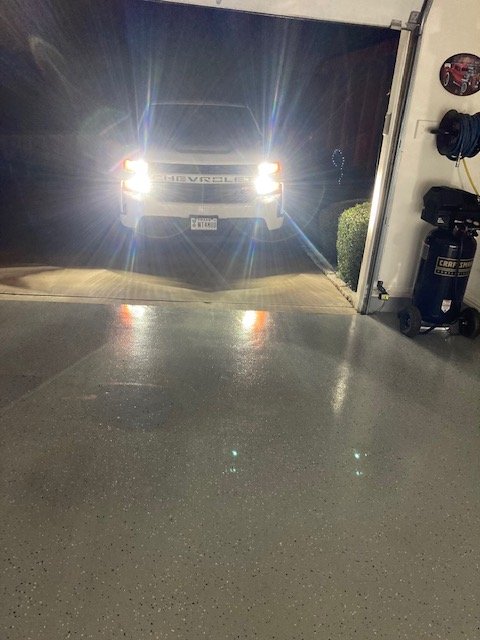

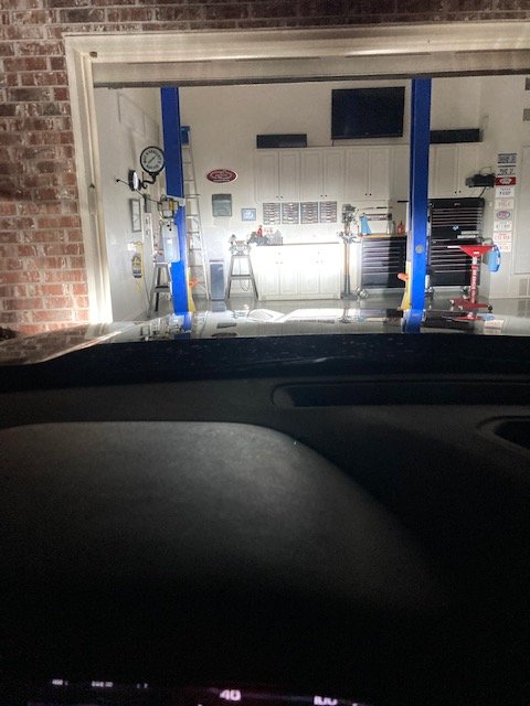

Changing to LED lights on my 2020 Silverado Custom Double Cab was my first modification.  The improvement was well worth the effort and the cost of LED lights in comparison to other mods was relatively affordable.  I purchased my lights from Amazon.  The high beams are Sirius branded and the low beams are CZ bulbs.  They fit nicely under the factory dust covers and the improvement in night time visibility is well worth the effort.  The low beams were relatively simple to install from the top, but the high beams were a challenge because of the longer reach needed to access them.  I found the easiest way to install the high beams was to pull the front wheels and partially undo the front fender liners to provide direct access.  My only question was whether or not the factory dust covers provided enough air space for the LED lights to run efficiently without overheating, and so far the lights have performed wonderfully.  I've attached some photos that show that the improvement

That is a good difference!!  Have you had any issues with these?  Another big thing, have any other drivers flashed you because your lights were too bright?  I used to get that a lot in one of my older trucks that had SilverStar lights installed that were super bright.  Were your LEDs plug and play or did you have to alter anything?

So far, no issues at all and no "flashing" from other drivers.  The bulbs were plug and play with no adapters needed.
