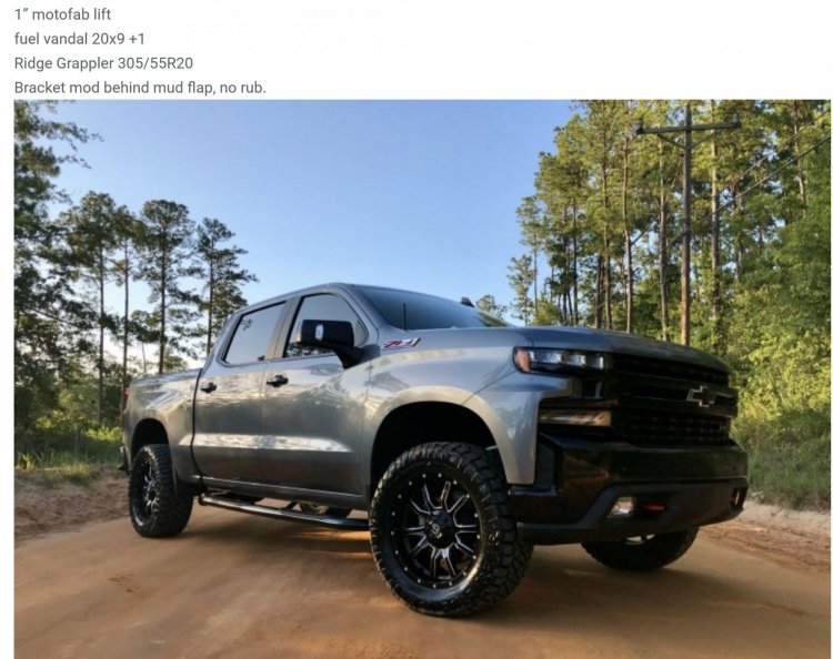

PS.  I absolutely LOVE the look of Trailboss75's truck.  Best looking truck I have seen, IMO.  I'll try and link the picture here, but that is the exact look I am trying to duplicate.

You would need a 3.5” lift for that look. That truck is a trail boss (2” lift) + 1” lift. The diesel sits 0.5” lower than the other trucks due to weight, hence the need for a 3.5” lift vs 3” lift.

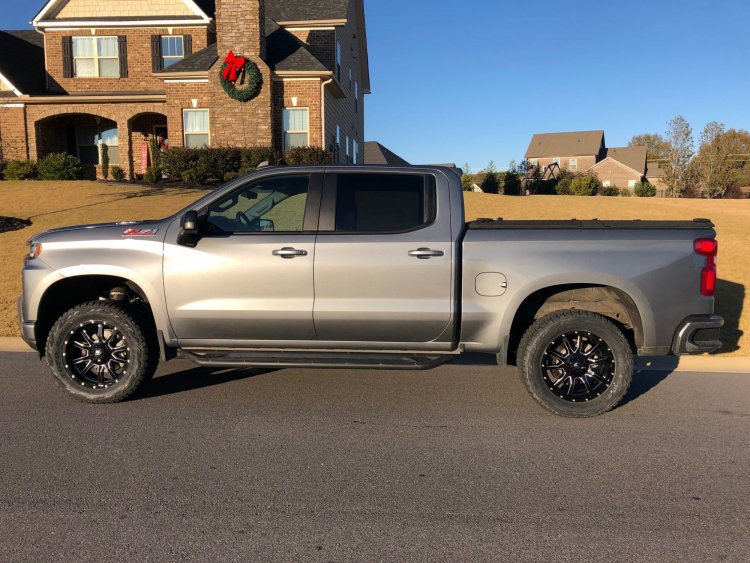

2020 RST Duramax 4WD
-GM 2inch Lift(Trail Boss Lift)
-ReadyLift Level Kit(For Trail Boss Only) 1.75” Level kit

So it looks like the 2inch GM lift is not recommended if your vehicle is equipped with the rear “composite” leaf springs...however I believe my RST 3.0 Z71 came with steel leaf springs...but I am going to double check...but I have not had any issues with the lift at all drives very smooth! I did take the truck back due to sone clunking noise which resulted in the lower control arm being lose but that was a quick fix...
