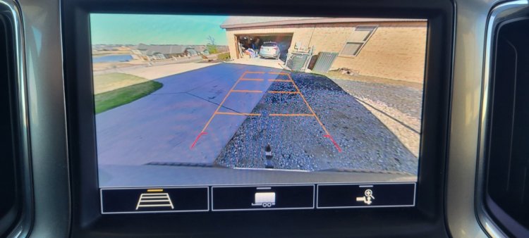

I bought a new 2020 Silverado 1500 and the backup camera is set at an odd angle. It looks to be skewed to the left as you can plainly see an increasing amount of the tailgate across the monitor. I thought it would be a simple fix, but call the local Chevy service department to see if it is a common problem with a fix. I was told that’s the way it’s supposed to be. I know the camera is off-center in the gate latch handle, but it’s a little confusing while backing up since the guidelines are centered, but the camera is skewed. Also the viewing area seems magnified beyond what I would consider normal. Has anyone else had these issues?

That is definitely not a software issue! It seems like the camera might have shifted in the tailgate button module. Ill take my tailgate apart tomorrow and see if there is any camera adjustment of any kind. (My camera is perfectly centered, but that seems rude of the service department to dismiss it as a software issue.)

We actually fixed on of these recently. Shim the left side handle retainer with a .50mm/0.02" flat washer
This isn't the repair for it in GM SI. But it will fix the concern.
