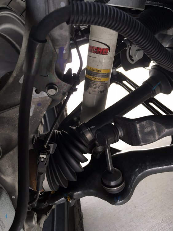

Here is my 2020 AT4 with BDS 2.5" coilover lift kit.  I would recommend you consider a lift kit (even if you don't go to the expense of new shocks) over a leveling kit to get proper geometry on your cv axels.  If you start at 2" with OEM AT4/Trail Boss lift - then ad 2-3.5" - you end up with pretty extreme angles and wear an tear will occur.  You can spend and extra $500 - $700 up front for proper lift and get good CV angles, or pay the piper down the road.  I had a 2019 AT4 with Ready Lift SST 2" level kit - picture below of CV axel angle - it i not ideal - RL states on site that they do not recommend using "auto 4WD" with level kit due to torque on the front diff from poor axel angels when shifting on the fly at speed.   Rough Country, Zone and BDS all offer proper lift kits that lower the front diff to proper geometry angles in the $1,000 - $1,500 range.  Level kits are $400 - $700 - so you get to decide.  If not dong much off road or using 4WD much - then level will likely be fine, but if off roading or using auto 4WD - buyer beware
2020 AT4 with BDS 2.5" lift with Coilovers
2020 AT4 with 2.5" BDS lift CV Axel - pretty much dead level
2019 AT4 with Ready Lift SST Kit 2" level kit - pretty extreve CV Angels - RL states - "do not use with auto 4WD"

Hi,
I had RL 2" SST on my 2019 - you can't use "auto 4wd" with that level kit.  CV axel angels are pretty extreme (see photos below).  With proper lift you spend more, you get level cv axel angles and the upgraded shock offer good ride and a lot of upgraded performance, especially offroad - but you do pay for that.  Zone (owned by BDS) offers a lift with no shocks - that is a good option if the shocks are too expensive - but add them later.  Only give up is when you drop the diff - you do give up some front ground clearance - stock is 10" - BDS to bottom of diff skid plate is a about 8.1" - so bigger tires are nice, if doing serious off road work.
If you decide to go with RL SST kit - cheapest place I found it was Tire Rack - $586 (was $512 when I got for my 2019).
LInk: https://www.tirerack.com/suspension/suspension.jsp?make=ReadyLIFT&model=SST+Lift+Kit&autoMake=GMC&autoModel=Sierra+1500+4WD&autoYear=2019&autoModClar=Crew+Cab
The kits are the same for AT4 and Trail Boss.   BDS has multiple options and Zone has level and lift option.
Link BDS:  https://bds-suspension.com/product?kid=749H
Link Zone https://zoneoffroad.com/products/4-in-ifs-suspension-lift-kit-2019-2020-chevy-trail-boss-gmc-at4?variant=33675658297432
2019 AT4 - Ready Lift SST 2" level - OEM 275/65/18 Duratrac's

you could compensate to reduce the angles from the 2" ready lift by dropping the diff 2 inches. this can be easily accomplished by removing the 4 bolts that hold the diff and using a longer bolt and poly urethane spacers. you don't have to reinvent the wheel here.
