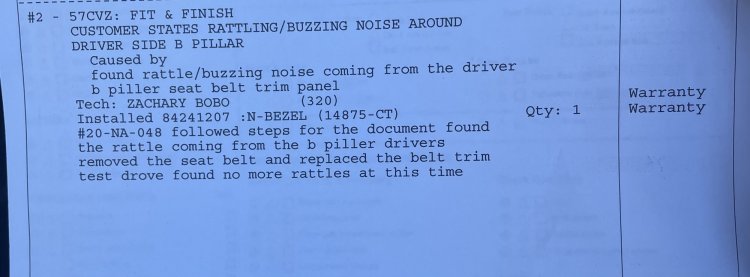

Anyone else get a buzzing sound in the B pillar when accelerating around 30+ mph? Sounds like a plastic type buzz. Taking the truck in for the recall on Tuesday, if anyone has any suggestions to help point them in the right direction I’d appreciate it!
It is the cover over the opening for the seat belt.  I took them off and put rubber bands and that took care of the problem.
Interesting. Took it to the dealer yesterday - they told me there is a TSB on it, and have ordered the parts to fix it.
