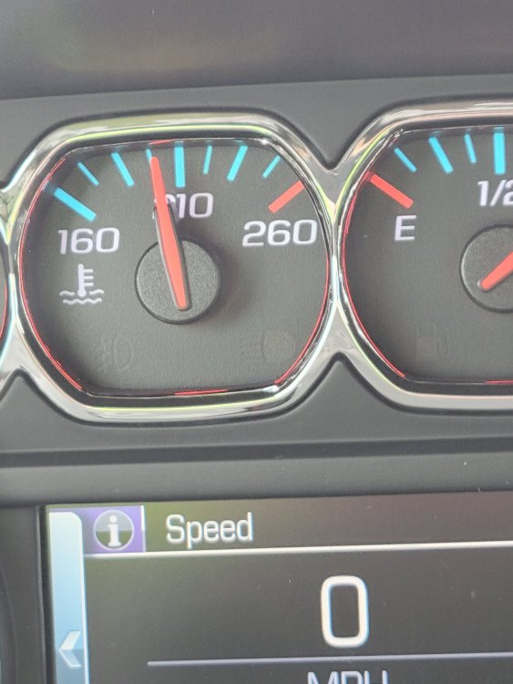

I have 2016 with 5.3. I’ve noticed even driving highway speed for extended time my temp gauge will not stay at 210 on the gauge. Any slow down for stop light or other light city driving the temp will drop some on the gauge. I’m assuming I should be maintaining the normal operation temp no matter ambient temp? Anyone else run into this thinking it’s a thermostat stuck in between.

It's not that a thermostat can't fail in such a short time but for the factory one this is unusually short. How much short of straight up is the needle? Got a photo?
That's about where mine runs all the time but I'm running a 170 F thermostat so that is low. What part of the country to you live in? Mine would get that low on really cold days with the factory 207 F stat in it.
