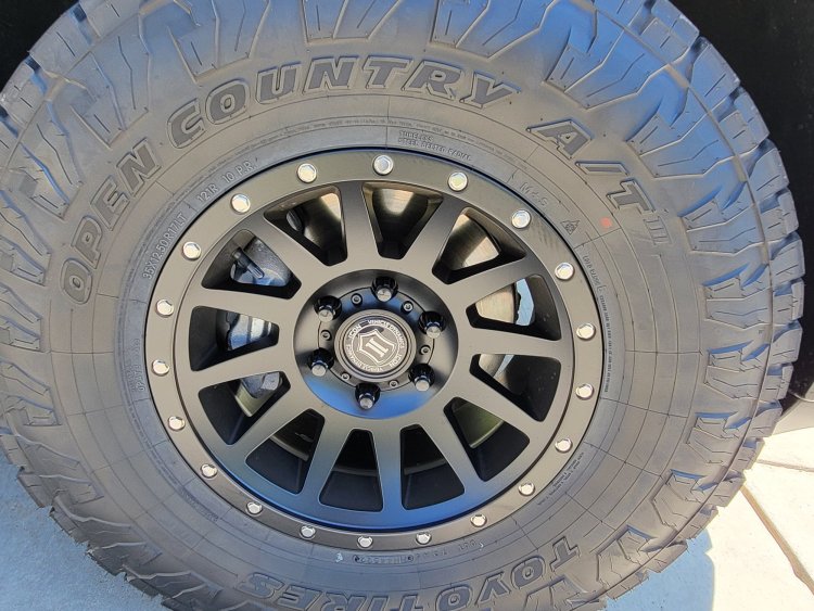

I just changed my wheels and tires on my 2022 GMC AT4. I went from the OEM 20” wheels with Goodyear Territory MT LT265/60R20 to Toyo Open Country A/T III 35x12.5R17LT. The dealer said no can do for relearning the TPMS on a aftermarket tire. I purchased the tires & wheels from Custom Offsets, and they said the TPMS should relearn themselves after around 250 miles which hasn’t happened yet.
