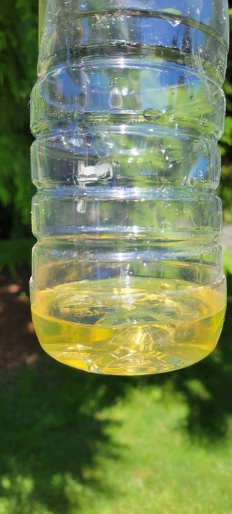

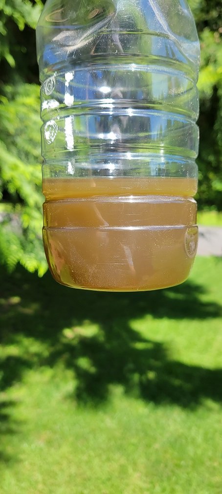

Decided to flush my brake system fluid. I have 51,000 miles on the truck, and have owned it for 3 years. Fluid in the reservoir looked fine and was between min and max mark.
I was surprised at how dirty the fluid coming out of the calipers and lines was compared to the reservoir was. I can't say I feel a braking difference after, but I will definitely change the fluid more often next time.
What came out from right rear:
What fluid from the reservoir looked like:
  • Thanks 1
Good pics & good observation. A lot of people don't realize that the brake fluid in the calipers gets the most abuse (heat & moisture) Moisture will migrate into the piston area where it's always espoused to the worst environment. The next place is the reservoir, as it's vented thru the rubber seal. A trick I learned years ago in Popular Mechanics mag, is when replacing brake pads, attach a clear PVC hose to the bleeder valve, crack it open & push the piston home. Instead of pushing the old fluid back up into the line & reservoir, you push it out of the caliper. That milky looking fluid has water/moisture in it & will corrode the caliper piston & it's bore, causing sticking brakes that will wear you pads & rotors out. I also suck out the reservoir & add new fluid about every year, just as a preemtive maintenance.
Good job & good share!
  • Thanks 1
