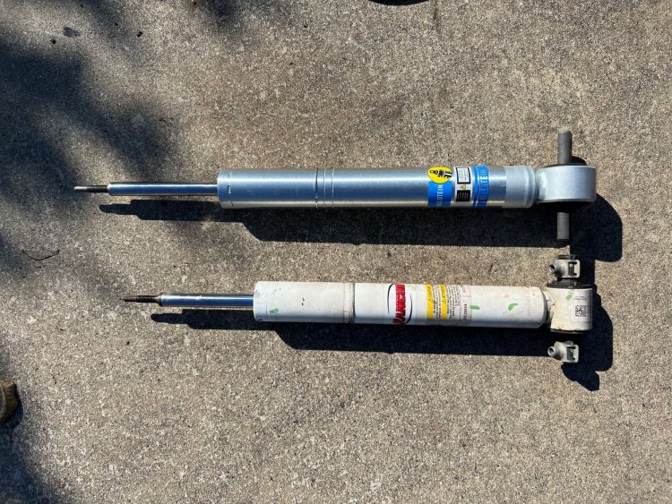

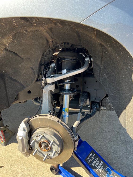

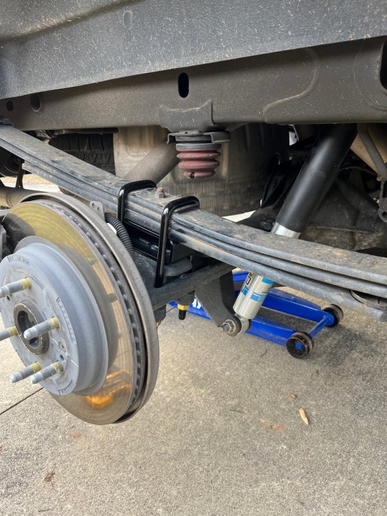

Bilstein 5100's front and rear (trailboss part number)
Rough Country UCA for 3" lift
Motofab rear 2" block with U-bolts
+2.5" in the front
+2.0" in the rear
I know the pic shows otherwise, but I put the front strut circlips set to the middle position for .55" of lift.  Wanted to maintain a touch of forward rake, and with the extra weight of the diesel it worked out perfect.
