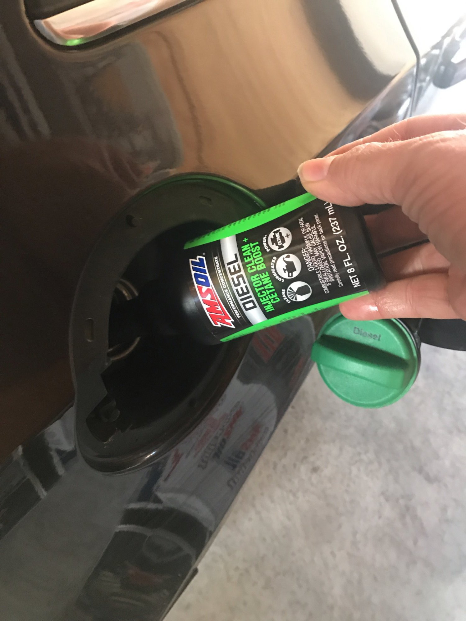

OK now I see.  I always put in AMSOIL's Diesel Injector Clean with Cetane Boost when I fill up my 2014 Chevy Cruze diesel.
