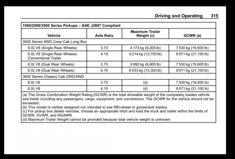

Some further info. I know this is for Silverado but Sierra has same equipment... 2nd photo just because the specs had (b) shown as a footnote although for bumper pull it doesn't apply.
If you need an owners manual, you can download it from GMC at this link.
https://my.gmc.com/content/dam/gmownercenter/gmna/dynamic/manuals/2018/GMC/Sierra/2018-gmc-sierra-owners-manual.pdf
