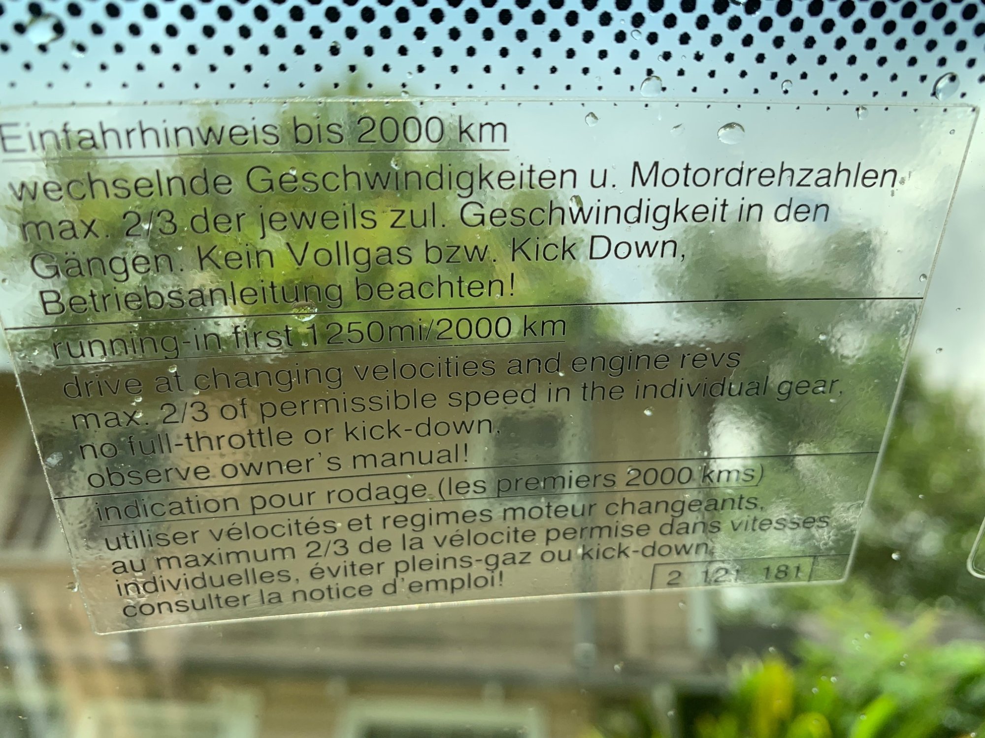

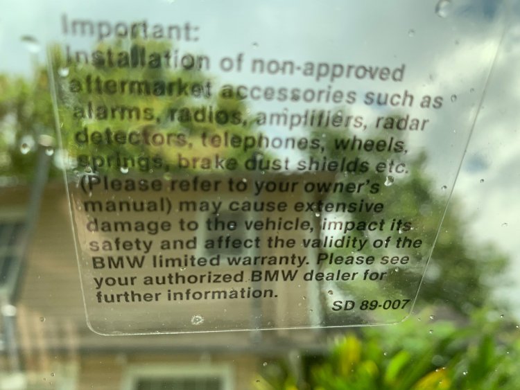

Thanks, Jim, I'm gonna have to check that out for my 1990 BMW, in the right light, I can see the years of wiper motions on the windshield.
It's original, with the original dealer stickers in place regarding BMW part usage and engine break-in instructions. After 30 years, they still remain in place.
