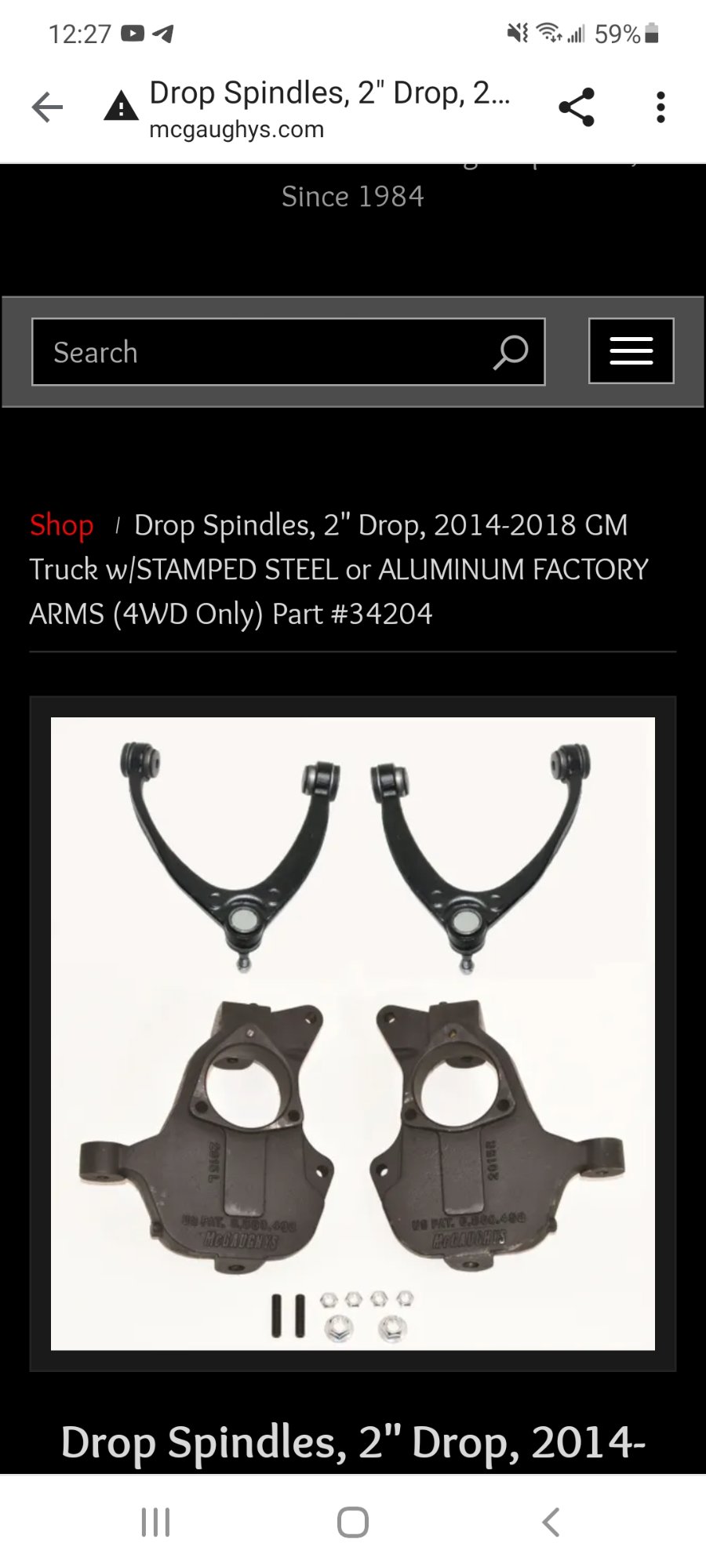

Hey guys I have a 2018 4x4 ( stamped steel ) silverado I bought a used drop kit and found out my 2" drop spindles are for cast arms only.
When I talked to Jason mcgauphy he told me with the stamped steel arms I'll also need a  new upper control arm when installed the drop spindles.
Have any of you 4x4 guys ran spindles struts and stamped steel control arms without swapping uppers?
Right now I have a 2/2" drop with struts and shackles

My 2018 has stamped arms and I used Belltech kit 1017SP. The kit lowers with spindles and struts. It is set at 2/4 now but it can go 4/4 by adjusting the struts. Belltech has a disclaimer saying not to lower a 4x4 by more than 2/4, but I know guys do it all the time. If you go more than 2" you need camber bushings (BEL:#4955) in the control arms to keep the alignment good. Maybe that's why they are trying to sell you control arms.
I believe that the UCAs are only needed to help the camber. I would go ahead and get them or else you are going to be doing the whole thing over again possibly.

My other option would be to swap to cast steel arms and toss the stamped steel that way my spindle would work.  It seems like the guys who drop trucks with cast arms don't need to swap uppers?

I'm pretty sure you need those Mcgaughys ucas

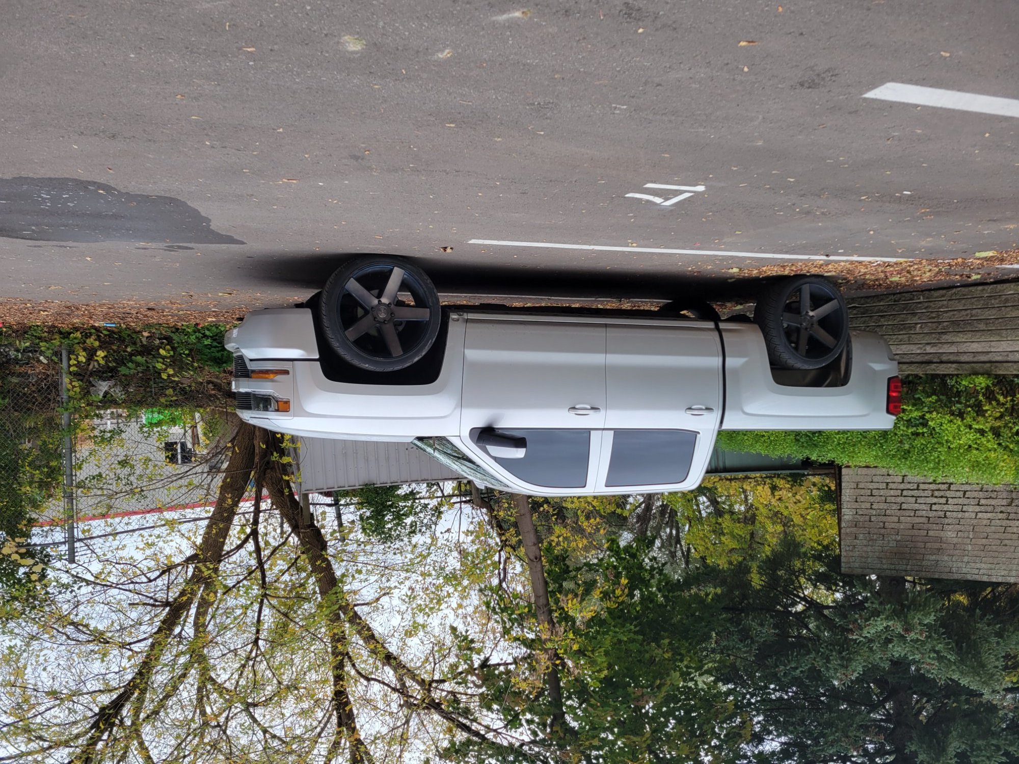

I'm not into the low trucks, but, damn, @Slowarado18 that looks good!
