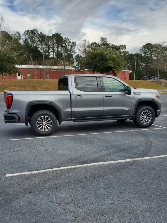

Here is a picture of what my TB looks like now in the back. I replaced the 2” block with a factory 1” from an earlier generation, which took me from a 2” rake to a 1” rake. I also replaced the original rear shocks with the RS7MT because they are about an 1” shorter. The originals would probably work because the bump stop limits the total compression. And the new shocks are black… I did use new, shorter U bolts from a Max Trac set that I bought. The factory U bolts from a non-TB or non-AT4 would probably work best.

Maybe a very slight improvement but honestly, not really noticeable. With the bed being empty most of the time, I didn’t want to get anything stiffer like Bilstein. Supposedly the gas charge on the RS7MT is somewhat less than Bilstein, which is why they are a bit softer. Here is the difference in length.
