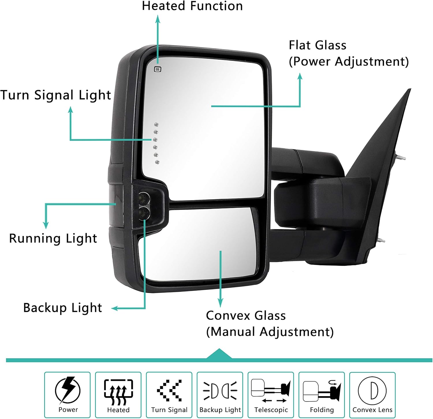

I have the towing mirrors on my Sierra and they have what I think are reverse lights (?) on the outside edge.  Mine are not working on either side.  Not sure if one is out and so the other does not work now or how that works or what the issue is.  Could it be a fuse?  I could not find anything in the owners manual at all.  Perhaps I am looking in the wrong spot.  Ha anyone also had this issue and if so were you able to fix it yourself or is it a dealer thing?

Do you know if they are original to truck or aftermarket?
On mine  I have to activate the cargo lights for those reverse mirror lights to come on. I have OEM tow mirrors but they are on a 1500.

Welcome to the site.
Are they controlled with the "toggle" switch in the center stack under the radio/HVAC?
See the source image
It is the cargo light button in the stack beneath the radio or as my granddaughter calls it, the squid launcher....  Thanks Mikeky101!

I had the tow mirrors installed at the dealer and all of the lights (Tow mirrors, rear cargo lamp and reverse lights, LED bed lights) come on when I press the cargo lamp toggle. They call it a work light feature and tow hitch hook up feature.
