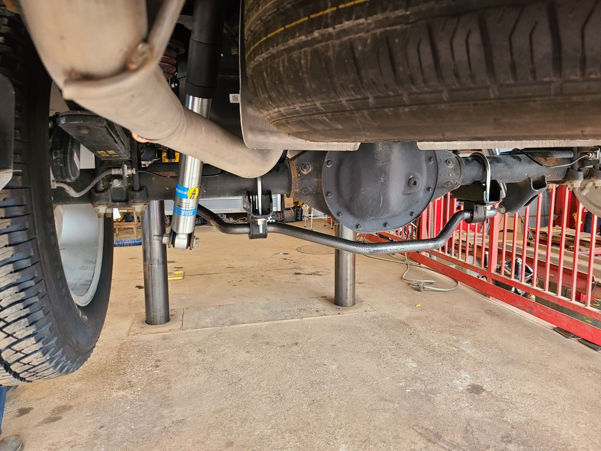

I think if you ask 10 people you will get 10 different answers.  Mine was as you described.  I have always liked Bilstein shocks and changed the Ranchos out for Bilsteins with about 5K miles on them.  It made a huge difference in ride quality as well as swaying in the turns.  I also added a front a rear Hellwig sway bars and am super happy with the ride as well as the handling.  Money well spent.
