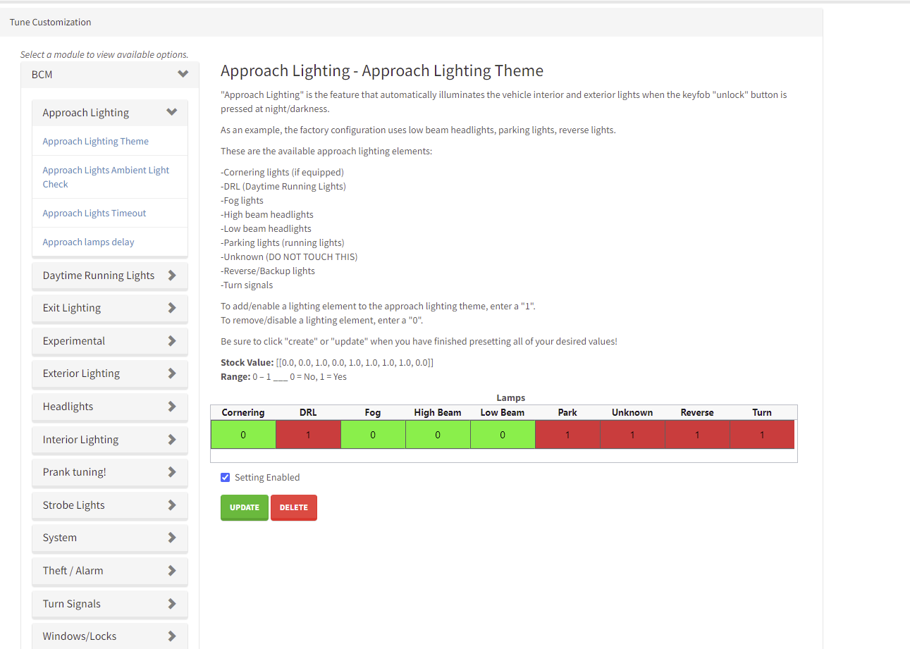

Thanks. I read it that I thought I had to send them the BCM. You don't have any screenshots of the changes that can be made, do you?
You do not need to send the BCM in.  You just make the changes in the portal as shown-->Plug the device into power and let it connect to your WiFi and download the tune-->Plug it into the truck and start the flash process.
Here, you can see I adjusted the Approach Lighting (when you click the keyfob at night).  The DRL, Park Lamps, Reverse, and Turn signals light up.  No eye burning laser headlights :)
@GTPprix is the original owner.  Good people
Edited by Rob Mugs
