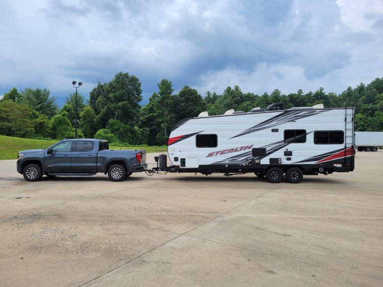

I'm towing a 28' toyhauler, loaded it's mid 8500lb.  When I run over the scales I'm right at weight limit for tongue and rear axel.
Using a 1500lb blueox WDH and it tows fine.  I've had no issues.  Only have 36000miles but brakes etc all are doing well.  Drive in your limits, use the scales and you should be fine.  20210807_113639.thumb.jpg.a7aaf863a1f4c1fc3be076d35af0b867.jpg

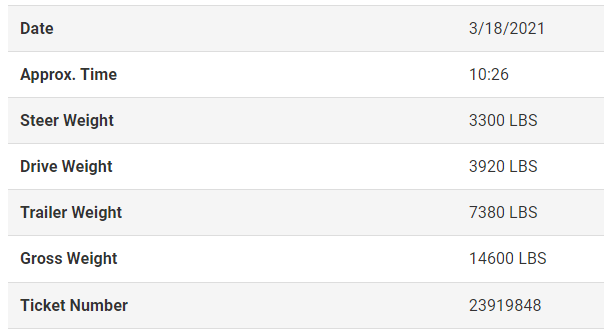

attached a scale number, was 120 over on rear axle, since then I stopped towing with full water, switch to lithium and moved the battery off the tongue into the trailer, and went from 1000lb bars to 1500lb bars on the WDH to get back under numbers just can't find that weight slip.
