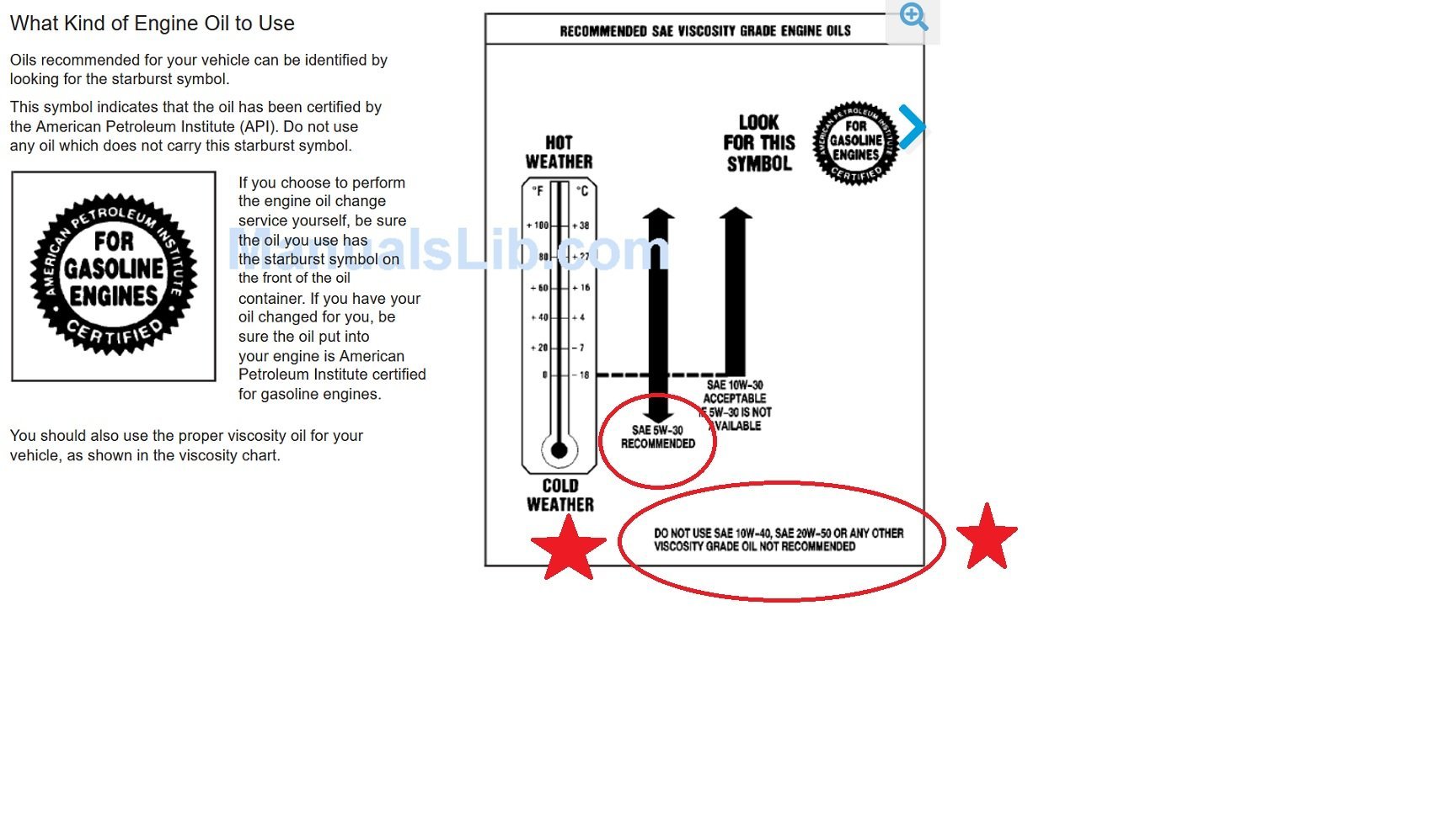

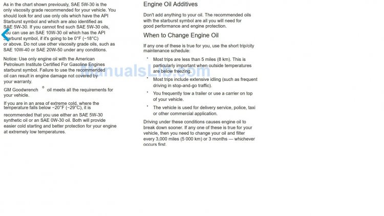

So I've read that 20psi at idle, normal operating temp, is fairly normal. My '03 with the V6 makes that at idle and over 50psi (almost 60) at highway speed.
I'm running 10w40, truck has almost 116k miles. Anyone ever at a quart or two of 20W50 to thicken things up for summer? Or should I just keep running 10W40?

Curious why the 10W40? I know why I would/wouldn't but curious as your reason(s).
^^^This^^^
From the little book that vehicles usually have in the glove compartment...
asdf.thumb.jpg.c183aacf214945c08225e11fc98815d6.jpgasdf2.thumb.jpg.110742539da35cf03cc811d8d0c216f6.jpg

I don't see a reason to make it thicker. It's not seeing crazy oil temps with how you use it. It's not a track car afterall.
No need at all.  I ran 5w-30 in my 2002 with the 5.3 with outside temps in the high 90's with no issues.  I even ran 0w-20 for over 5k miles to see if it made a difference and it didn't.  This was at 150k on the truck at that time.
5w-30 is all you need.  10w-30 would be fine as well.  No need for 10w-40.
^^^^ Agreed. At 116k, I'd still be running 5w-30 and nothing more than 10w-30. Your "thicker" oil isn't going to gain you more protection with today's oils

I do not understand how people think they know more than the manufacturer or engineers. I would only use thicker oil if I had an oil burning problem or severe conditions such as heavy towing in desert temps.

Thanks for all the replies. I'm a boring old geezer, no speeding for me.
I'll reconsider my oil choice and shelve the 20/50 idea altogether.
