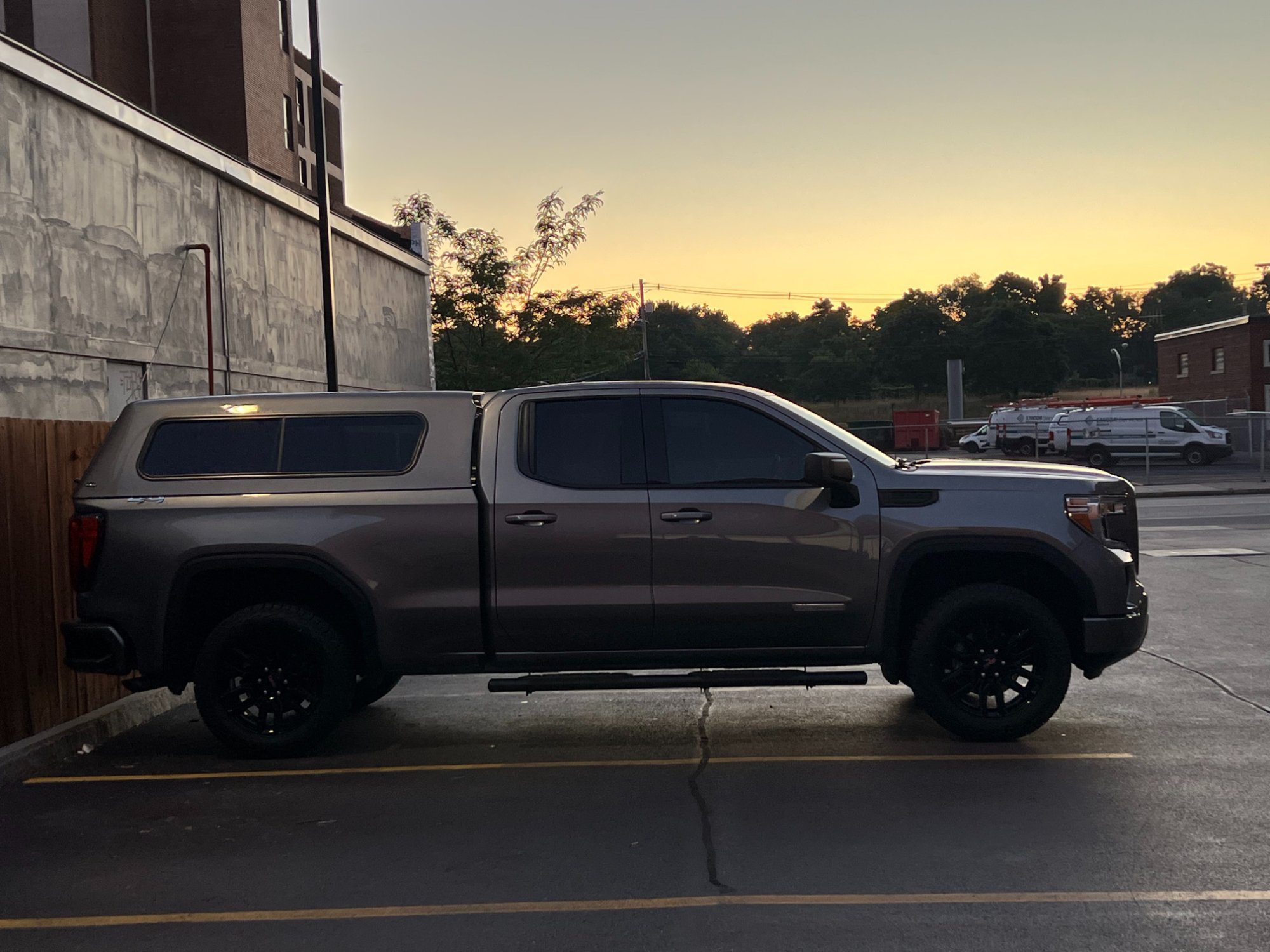

I used the 5100's set at +2" to the front of my 2022. increased the tires size from 275-60/20 to 275-65/20. Tires are an inch taller at 34" vs stock 33" The combo raised the front 2.5" and the rear 0.5".  Truck is perfectly level. The Body style for the 2019-2022 makes it look a little front high sometimes so I'm adding 1" rear blocks this week to give it just a little rake.
No other leveling kit was added (i.e. spacers) I think the shocks are the way to go for leveling and there is no need tor spacers unless you want to go higher. The pic is how it currently sits with out the rear blocks.
Just go with the 5100s in front and back, no need for additional leveling.

Just wanted to thank everyone! I went withIMG_2472.thumb.jpg.a6df1ae96144793f7462bb6ced0a49f0.jpg the bilsteins and new tires. And it rides great and looks amazing.
The extra lift in the front makes a huge difference. Thank god this actually feels like a truck now!
