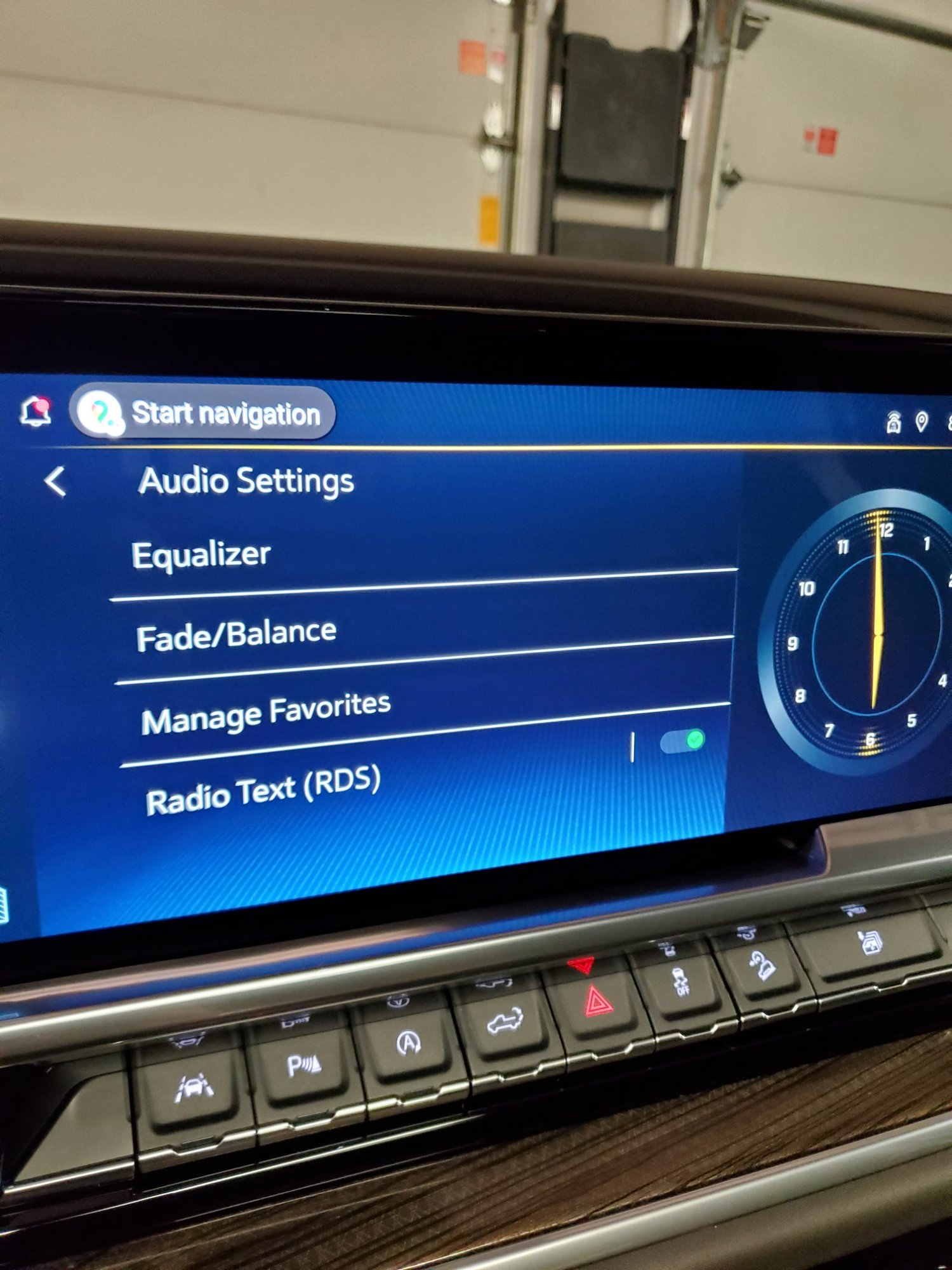

Do the new 2022 trucks with BOSE have the automatic speed sensitive automatic volume ?  I thought my 2019 had this.. can't find anything in the settings of the new truck.

I don't see it on mine. I have a RST with the BOSE,  RST Premium Package.. basically everything you can get on a RST.  Does anyone know if there are (2) different levels of the BOSE stereo?  Does the High Country have something more with that BOSE?

I looked tonight, could not find an auto volume setting anywhere on my refresh high country.
Thanks.. I assume if it's not on a High Country.. it's not available anymore. Or maybe it's just automatic or built in now without a setting.
I've not seen any setting for it on my High Country, either. Either built-in or not available any longer. Maybe we need the $1500 OnStar plan for it to work?

Seems the feature is a Denali Ultimate and AT4X thing only. (I copied previous post info from a sierra manual)
2022 refresh and 2023 order guides shows a 7 speaker bose package and a 12 speaker bose package.
UQS    Bose Premium Series with 12-speaker system with CenterPoint, Richbass woofer and AudioPilot
Standard and only available on AT4X and Denali Ultimate trim levels (and not on AT4 or Denali trim levels)
On silverado the UQS 12 speaker Bose option doesn't show as available (does show the 7 speaker)
UQA - 7 speaker bose is standard on HC

Interesting... so I guess there are (2) different levels of the BOSE radio now. I wonder if the new 7 speaker BOSE on the refresh 2022 even has the center sub?   I know my 2019 BOSE sounded better than the new 2022
Doesn't have much description, but this is what the order guide says for the 7 speaker bose:
UQA    Bose Sound System, premium 7-speaker system with Richbass woofer
Might be more info on the Chev and GMC websites??
