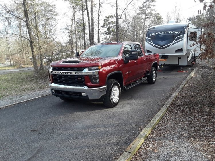

This is kind of a confusing topic for me.  With our 2022 custom model crew cab gasser picked up our new 8k lb. camper in mid September in Jacksonville, FL.  I towed it 255 miles to Byron, GA in 95' heat running at 65mph.  Trans never went above 182.  Today I towed our camper from Byron, GA to Goodwater, AL.  Trans never went above 170.  It was 45' out, super cold for us but I've never seen it above 182 in very high heat and lots of hills...Is it safe to assume this was an earlier model problem?

My 2021 was built in the March/April timeframe in 2021. They switched to the lower temp thermostat a month or two after that. Your 2022 has the lower temp thermostat.
