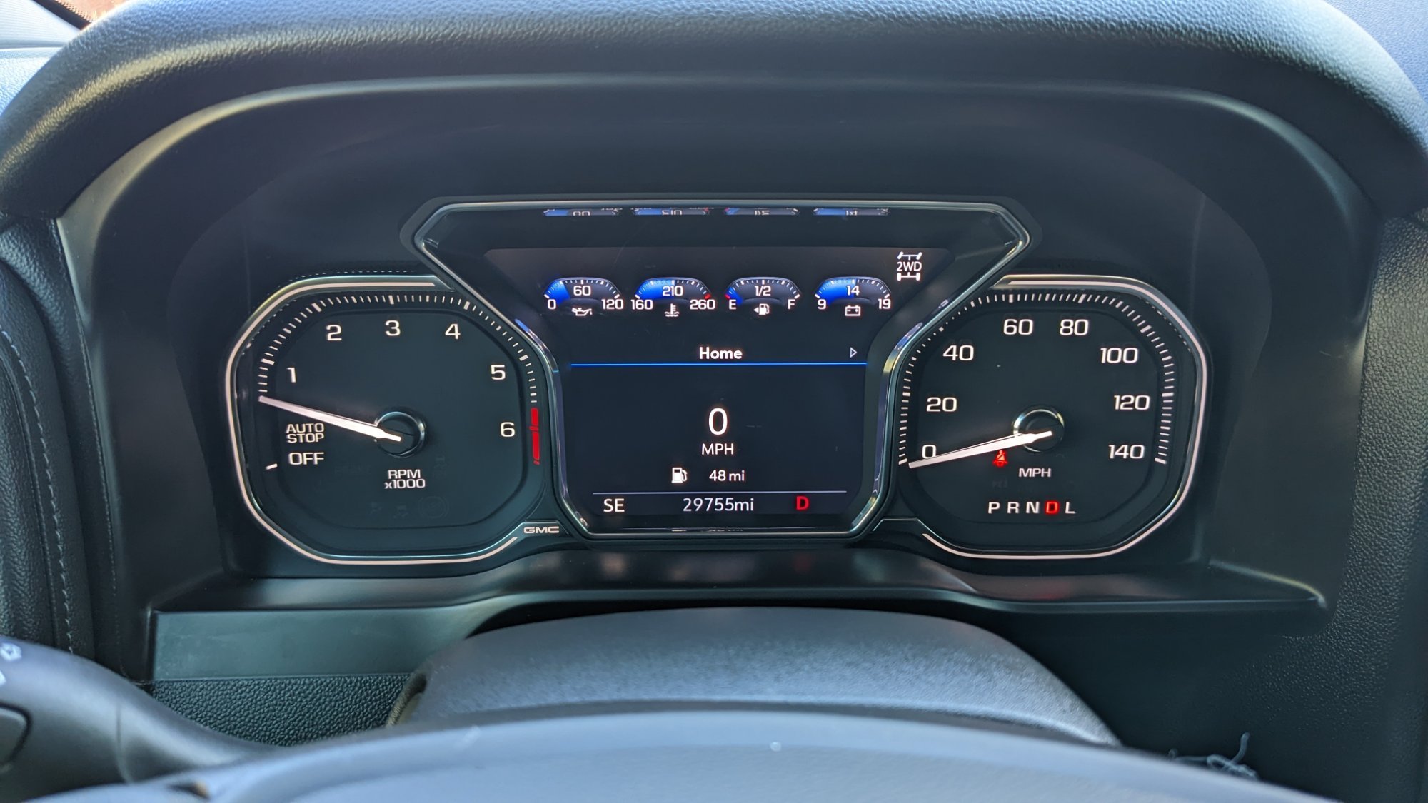

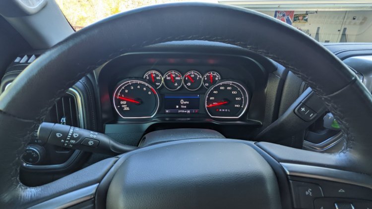

Just posting an update. After talking with WAMs, they let me send my cluster in for programming. Supposedly it was already WAMs program but needed my VIN.
Got it a week or two ago, but was nervous just in case something went sideways. Bit the bullet today and literally 15-20 minutes letter..
Before and after...
It look 100x better. Altogether it was a little over $535 to aquire cluster and get it programmed.
Def the way they should have came.
